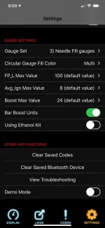

That is the apps default, I have not modified any of the settings besides which map I am using.
It shouldn’t be. Default is 20. Check the n54tech page
Weird... It says default value 24 right in the app.
That’s the highest it will read to on that gauge unless you change it. So hypothetically if you are running 30 psi or will only read 24 Best bet would be just go into user adjustments and change the safety to 20 for safety sake
Ah, thank you for noting this, I will adjust it. :)
I change my safety to 22 but only when I run map7. Otherwise it’s always 20 lol
