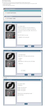

In my case, I have a 2022 USA-spec G70 3.3T RWD in Sport Prestige trim and want to add the power trunk and full digital cluster.
The procedure for swapping the cluster is outlined in the sevice manual. You need 3 things:
1. A New Cluster
Easy to find and order.
2. Genesis GDS (scanner / programming tool)
The cheapest route is to make friends with someone who has this, know a tech at the dealer, or buy a cloned one. The real ones go for about $2500.
3. The "Variant Code"
This is my current blocker. The variant code tells the car / component what other modules to expect. But how does one find or calculate a variant code?
Once you have those three things the procedure is a piece of cake.
1. A New Cluster
I've been looking for the CLU variant code for a while as well. The Hyundai Tech Info site is supposed to give you your current CLU Variant Code but doesn't (I only get ACU) back. There seems to be some kind of Russian hacking software that manages to calculate the CLU code and it (allegedly) works on the G70. Here's the site or Google for the CAN-Coder-New on a site called canhacker.
