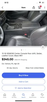

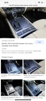

Hello. I am on track to purchase my first g2 Sedan. I love the interior that the tech package has with the rotary dial. But the genesis that I am purchasing does not have all those buttons. I did look online and found a center console for around $360 which i don’t mind paying for. But the big question is will it fit? The first photo is the center console it has and the second photo is the center console I want. Is it possible??

I don't think you can simply add the buttons to gain the features...
thank you
Will it fit? Yes
Will it work? Doubtful
Everything goes through computers and relays these days so not so simple. Something has to know what the jog dials wants and get it to the screen.
I'd shop for an Ultimate and you know it works.
This may come as a surprise, but the car that you don’t even own yet likely works just fine the way it is equipped. You simply touch the screen to use the features. If you can’t stand the thought of owning a car without a jog dial, find one so-equipped instead. Also consider spending your money on an extended warranty.
