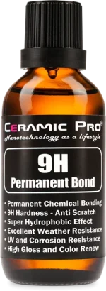

Just keep in mind no two ceramic coating services are alike. We have a very well known detailer here in North Georgia that specializes in sports cars and high-end vehicles. They are recognized in the area for their nano-ceramic coating services offering 4 different ceramic coating packages from Basic to Gold Package. Basic covers hand detailing of the paint surface and only 1 coat of ceramic coating (6-month warranty). The Gold Package includes hand detail, clay bar, buffing prep, 2-step paint correction and more and includes 5 coats ceramic coating (Lifetime Warranty). Therein lies the price ranges others have referenced; $200 to $1500 +. Just some cautionary advise to know what you're getting for price paid. In no way am I connected to a car detailer or ceramic coating service. Attached is pic of the ceramic coating used by the detailer referenced here.
Good input, they have 4 levels of packages. I chose the Premium, hand wash-claybar-buff & paint correction-base coat+top coat on paint, 1 coat on windshield+1 coat on wheels. $799
