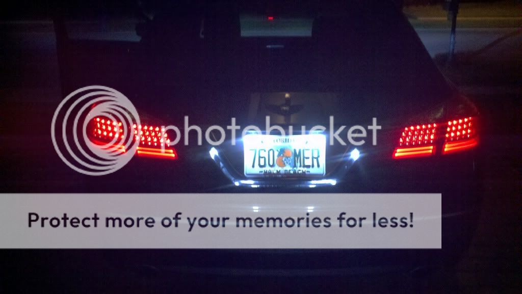

got these off v-leds for 7 bucks each. but the sale is over now so they went back up to $14. these things are SUPER BRIGHT. i literally could use them as my reverse lights. and yes they are angled properly.
HERE YOU CAN REALLY SEE HOW BRIGHT THE GROUND IS LIT UP
they look great! brighter than my 6418's.which bulbs did you use?
