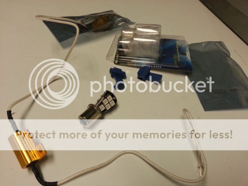

Gonna change out my rear signals off my 2013 sedan and replace with LEDS. Just wondering what color wire is positive and what's ground? It came with a load resistor oi beelieve and I'm not sure which wire to put it on (positive I'm thinking)$ lmk. Thanks guys
Here's what I'm working with.
No idea how to run this. Plus looks like both wires leading to the bulb are yellow, though I'm assuming the wire with black writing might be ground. Couldn't get my fat fumbly fingers to rotate and pull the stock bulb out
I have changed the rear turn signals to LED bulbs like you have pictured, but the load resistor was built-in, so no BS hookup for install. Problem with those bulbs is they are not bright enough and the sun will wash them out completly at the right angels.

Ok. So I looked up online and it said to run it parallel to the bulb. To bad my bulbs are all shot. Gotta get me some new bulbs now.
