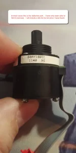

The underlying switch that breaks on DIS is a Grayhill Joystick Optical Encoder. The part number for component I had on my 2009 4.9 is 60AY18031. If you can source one of those you can repair the board rather than buying the whole DIS control module.
The plastic internals on the joystick are prone to breaking and cracking. Especially if there's been a hard push or impact to the top of the control knob. Once it starts acting up you'll have to either replace the whole unit or just the joystick component.

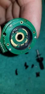

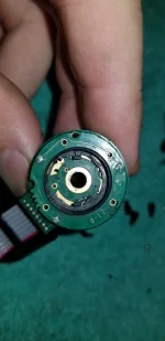

This was awesome information, and exactly my situation. There is no amount of cleaning that will compensate for the broken internals of the 8-way encoder. One of the thin, black plastic spacer rings inside mine had broken into several pieces, and debris was also scattered throughout the inside of the switch. I cleaned, reassembled, and tried it, and it was "better", but still had frequent periods of non-functioning "Enter" key operation.
I did find a US distributer for the part (and even more local to me, 1 day shipping time). $65 plus tax and shipping. Link here.

After completely disassembling the unit, This by far has to be the most common failure point. After finding it for ~$75, I couldn't even fathom taking a chance on the used e-bay parts.
BTW, my knob was also broken, with the d-shaped keyway part missing. Drop of hot glue in the hole while reassembling fixed that, too. I've had it off a few times since while waiting for the new encoder. A good tug pulls it off, and some alcohol and tweezers make short work of the leftover glue residue.

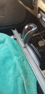

I also fabricated a tool to remove the shift knob. I broke plywood, lumber, and bent 1 1/2" slotted angle iron trying to remove mine. It's easier now that it's been off a few times, but that first time was tough.
I used some c-channel from home depot, used the grinder to notch it, filed smooth, and pried up with the opposite end on a ~13" 2x4 laid up against the driver's side of the center console.
Will attach some pics in a bit from the phone.

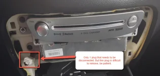

I just finished replacing the Grayhill switch this afternoon. Purchased a trim removal toolkit, as well, from Amazon. I ordered the switch from a company called DigiKey. They stock all sorts of electronic parts: https://www.digikey.com/
I did this with my car parked on the street. For safety, turn the wheels all the way to the right, shift into neutral, engage the parking brake.
Removing the shifter grip needed considerable force. To avoid bloody knuckles from striking the head unit when the shifter knob finally releases, try wearing gloves. I wore my trusty Isotoners. Also, use the shift lock override to put the car in neutral. That way, the shifter will be pointing straight up, with much less chance of your hand striking the head unit.
With the trim removal tools, the trim removal was far easier than I thought it would be. I found the most difficult part to be removing all the electrical connectors, which can be finicky.
It was far easier than I thought it would be, took a little less than an hour. Photos attached.
