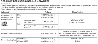

My 2013 3.8 takes a full 6 quarts for an oil change.Lubricants_and_Quantites.webp
Yea, I drained oil and changed filter, and put 6 qts in my 2012, and it was overfilled. Had to drain some out. Odd.
Mines a 2013 3.8 but I have no issues with 6 quarts. Maybe there's a difference in the dipstick or the dipstick tube.
The distance on mine from the top of the dipstick tube (bottoming shoulder on the dipstick) to the full mark is exactly 24".
