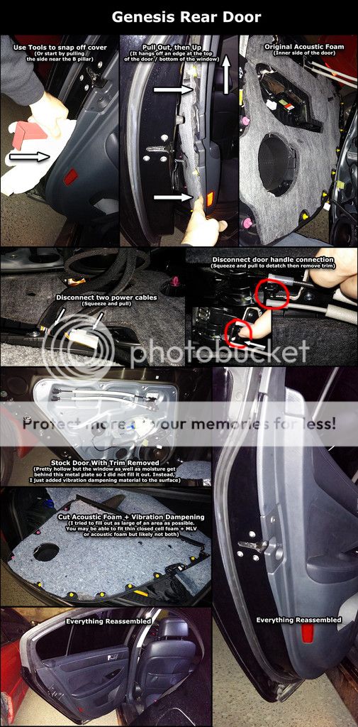

How did you remove the panel?

Could you take a picture of where you sprayed the silicon please. I cannot for the life of me figure out where the door panel meets the door shell.

Here's how to remove the door panel and what it looks like if anyone's interested. For the front doors you also have a small plastic screw at the front of the door (towards the motor) which holds the top plastic piece (with the tweeter grill) attached.
