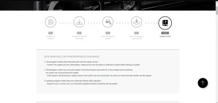

EDIT - in spite of a flag stating that the software update would continue in the background while the vehicle was turned off, this didn't happen. I had to babysit the update for nearly an hour while the car was running. Also, once the vehicle was completely updated, there was still an option to update via OTA - not sure if this is redundant or there is additional software that wasn't included on the USB stick download. Thoughts?
Just finished updating, took 58 minutes. 1st tried updating with car engine off, in ACC mode, failed after few minutes because power automatidally turned off. 2nd time was successful with car engine running.
I am attempting the update sometime today and will report back later. Here is part of the web based app My Genesis with some "how to" information in the Map Update section that confirms your experience.

I was not given the option for update while the car was off. The option was there, but it would not let me chose it, but my battery was at about 55% so that might be why.

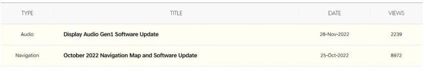

Have you checked the website lately? I noticed it when I downloaded the update for the 2nd time. It listed two updates. And you would have noticed it because you had to click on OK or something to continue with the upgrade.
Missed that. Thx!
This is what I had when downloading. Also, since I was driving the car while I kept the update screen up on the display I watched the progress. It does the map/nav one first which takes about 75-80% of the total update time then it actually prompted me to continue with the audio update which finished in about 15min. It may have finished without any prompt response by me but I didn't chance it.
I’m not sure this audio update pertains to our cars. It says it’s for Gen 1 systems. If you look at the details, it’s clearly for an audio system on older cars.

Well whatever generation it was, it updated on my 21. It did the maps first and then the sound system.
Yes, the picture referenced the Gen 1 audio update, but the current update for the GV80 does in fact update the audio system too.
