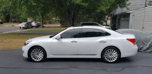

Thanks much! Yesterday Carmax Maple Shade NJ agreed to credit me the extended warranty I bought, over $1500. Hyundai of South Brunswick NJ is putting together the necessary info for trans approval from Hyundai. Car will be right in the end. Pic in my driveway... No worries.
Nice !
