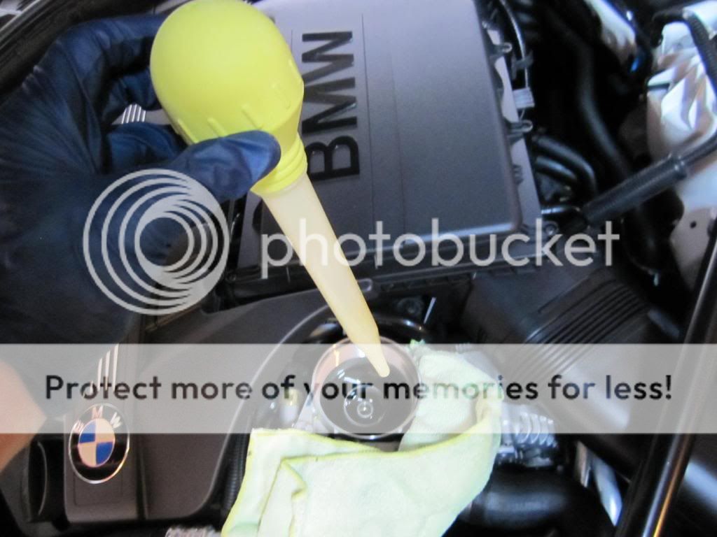

I know most people don't have the inclination to do such things. I did a DIY for my BMW and the another reason I do it myself is that the dealer will not do certian things such as suck out the oil trapped in the filter housing. I know it most likely doesn't make a difference, but it's something that since I have a garage and tools and the inclination to do myself, actually enjoy doing:
