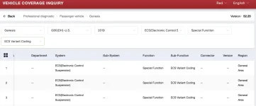

I'm looking at the launch x431 pro elite. It looks like it may be able to do variant coding changes.. if anyone has any experience with it on our cars, please let me know!

I hooked my Launch X431 Pro to my 2019 G80 and found no available coding options that weren’t already available in the car’s dashboard menus. The Launch can do maintenance items like resetting oil change reminders, programming TPMS sensors, etc., and I was able to program the car for a new key fob, but the car is locked down pretty tight as far as coding goes.
According to the launch vehicle coverage, the G80 does have support though it seems more limited then the G70.
G70 Suspension coding
Well I stand corrected. My Launch X431+ Pro gives these options for ECS variant coding.

Ok, sweet. So what are the options? Can you change it to Europe/Asia?
It took me awhile to resize the photo and get it attached but it now shows the options.
