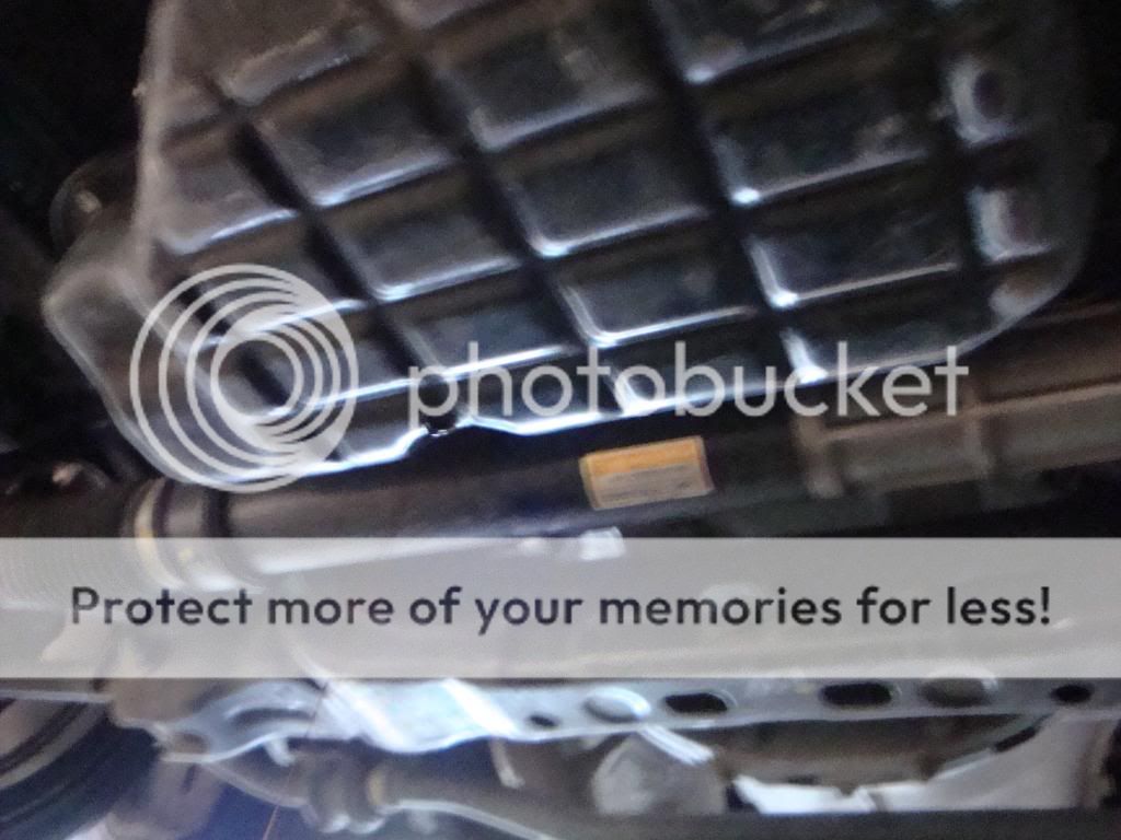

Getting ready to do my first oil change on the car and get rid of the factory fill oil, and was curious as to where exactly the oil drain bolt is located underneath the car? Also do you have to remove any undercarrige covers to get to it?

I will try and get a picture for your tomorrow. Once you jack up the front end of the car, coming from under the engine you will see a plastic cover much like you see covering the engine. It's the only thing there, there is a circular space that has the drain bolt. It is really one of the easiest oil changing systems I have ever dealt with. It is the only bolt in the entire plastic covering, jack it up and you can't miss it.

It will be obvious to you once you jack the car up. Once you remove the plastic covers under the car, the oil pan has a waffle like structure. Read the other posts about what tools are needed and the fill amount/dip stick issue with the V6 sedan.

Why would you remove the plastic shroud underneath the car? There is a hole / opening for the drain plug.

It's a V6 coupe, different, but mostly the same. Funny. Oil doesn't come out in a nice even way. I have done it both ways and made a mess with the cover on, but you're right it's not mandatory. But it's good to take a peek at other parts of the car and see if anything is leaking, loose or, other...
Polish away! You are right, before pulling the plug, I stuff a rag along the top of the shroud to avoid the oil flow making inside the plastic cover and then later leaving drips.
Last time I pulled the cover off, there was a lot of pebbles and dirt that had accumulated. I dumped them out wiped down the inside of it, then used a tooth brush to get at the nooks and crannies.
