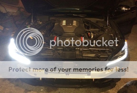

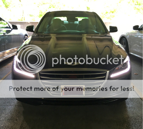

Mission accomplished. 2016 LED light intensity on a 2015 (in parking light mode shown). Directions above work well - one wire change on each light assembly. Had a co-worker do the bumper removal in his well-equipped garage - said it was straightforward and easy, but lots of clips, etc. to remove.
Thanks again to Dthomas1 for the pioneering work.
One side completed comparison:
Completed:

I am probably going to try doing the wire move this weekend. The pictures show a pretty significant change in brightness... I like that a lot.

There was a pretty significant difference in brightness, especially if you crouch down to "oncoming car level"... and at night it is just ridiculous. I am pretty impressed, I have to say. You no longer see a string of individual LEDs... it looks like a solid bar of bright light. Not quite light-tube in nature, but pretty close.

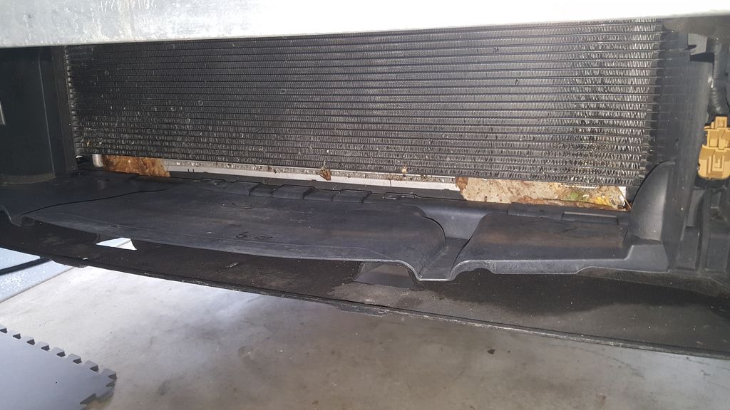

One other thing you can do while you have the bumper off - clean out the bottom of the radiator. Seems to be a catch-all for everything that has flown into the grill. I found a nice pile of leaves and even a small rock collection.
