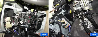

I would start at the IPM module. That’s going to be under the steering column, on the left. Found a picture of it online.
