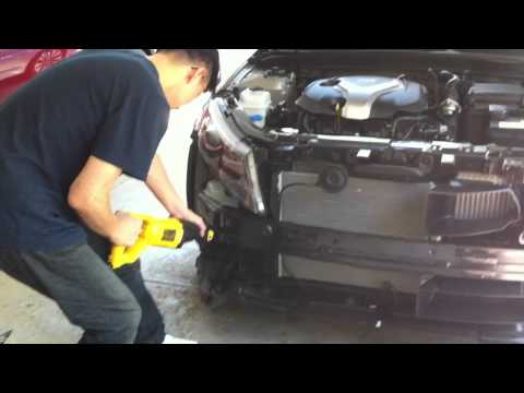

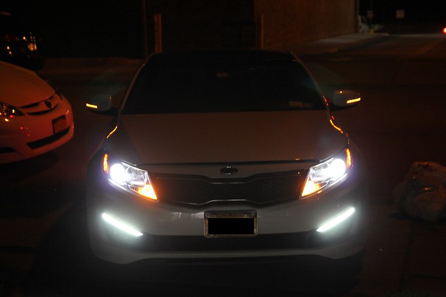

Oh geezzz.. by the look of item description... part of bumper bar needs to be sawed off for these fog lights to fit. Same had to be done on my 2012 optima sx turbo to get OEM LED DRL installed. Because USA models needed "longer" bumper bar, they couldnt fit LED DRLs that were standard on over sea models. For 2013 year model, KIA installed modified bumper bar that accommodated these LED DRLs at the same time met US regulation which is optima SXL trim.
Kia-Optima-SX-bumper-cut-for-DRL-install-v-Z8Y0V2e5HT4 by LouKango, on Flickr
IMG_1604 by LouKango, on Flickr
I'm guessing bumper bars on 3.8 are different from 5.0 models
