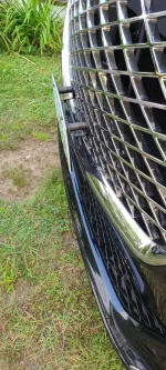

Hi all. Took off my front license plate this morning and found a bracket underneath. I took out the 2 screws, but it is secured in some other way...assume clamped on somehow. I pulled and tugged but don't want to risk cracking the grill. Anyone know how I can get this off?

FYI. The front license plate bracket from Genesis doesn't drill into the bumper. It has plastic brackets that attach to the grill. Doesn't damage the grill.
Once you remove all the screws you have to squeeze these brackets together to get it to release from the grill. Pictures will show you where they are and how to squeeze them. It's tight back there.

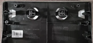

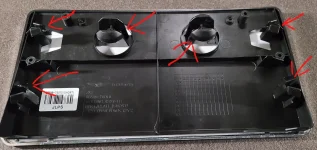

Thanks!
