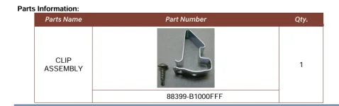

Help, how am I supposed to take the clips out of the seat? I don't want to break them by pulling too hard.

I pray you help me, how do I get the clips out they're not coming out when I pull? :(

The metal clips pinch together with a pliers and simply pull out. Might take a tug.

Thanks you! This worked perfect. Took 10 minutes, hardest part was getting the metal clips out of the back. Just lift up from the bottom of the clip and it should pop out for you.
