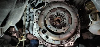

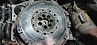

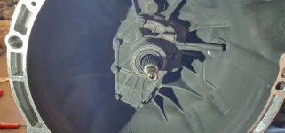

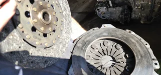

well... they finally had time to diagnose the car and its worse then originally quoted... To be replaced:
Flywheel
Clutch disc
Pressure plate
Release bearing
... now its $4200 to fix a 2 year old car! woooooo....
Anyone have experience with this? I'm not a car guru and this was my first "brand new car" so I'm really in a "wtf" headspace right now...

can't tell much from the first 2 pictures. what is wrong with pressure plate and release bearing? or is replacing these with the job 'best practice'? pressure plates seldom fail, however some gearboxes do have systemic issues with the release bearings. my G35 and G37 had similar issues and this was often covered under warranty since it was a known flaw.
#3 there's hot spots on the flywheel which i believe happens from slipping the clutch or aggressive driving - essentially lots of friction getting the friction surfaces really hot. this causes chatter and rough engagement of the clutch disc. if the flywheel is dual mass it can be difficult to resurface and many shops would just re+re. if machining it is an option that is best.
#4 looks like there is decent amount of friction material left on the clutch disc. is there some other flaw?
the only thing that could lead to your symptoms would be the release bearing or pressure plate failure. my thought was something to do with the hydraulic system. the pedal dropping to the floor on its own has nothing to do with the flywheel or clutch disc.
i would ask for a clear explanation of why these parts are being replaced, and how that would solve the problem. you don't want to just throw parts at the issue only to have it be caused by something else.
Yeah, with his symptoms, the immediate suspect is hydraulics indeed, therefore the slave and/or master cylinder, assuming fluid level is correct. Maybe dealer inspected them, and found them healthy? At any rate, looking at the flywheel and pressure plate, there was definitely overheating going on there, which means abuse (hard launches, etc), and/or undesirable driving behavior (inadvertently riding the clutch, holding vehicle with the clutch on an incline, etc.). Overheating can cause fluid to boil, which would explain the pedal-to-the-floor behavior, due to air in the system.
The bottom line IMO is those photos don't point to a manufacturer's defect, unfortunately. But now that the car is torn down, I'd absolutely replace everything mentioned, to start with a clean slate. Good luck.
