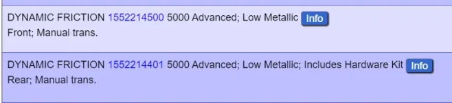

^ just to follow up to my earlier reply, this is the pad i would lean towards on rockauto's site:
from my read this closely matches our Euro pads. heck, DF may be an OE supplier for all i know. these pads are in the "Daily Driver" category for our 6MT trim (=Euro factory pads). the other DF 3000 pads are in the "Economy" category, and may not give you equivalent braking performance.
