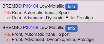

Sounds like the one they tried to pull on me ($500 per corner just for the pads, I ended up doing it myself for <1/10 of that price). If your car is still under warranty, I would insist to get it covered by the warranty. They changed the front rotors under warranty in my case (they should have change the pads too but they tried to pull their shenanigans). I know several other people who had their rotors replaced under warranty. For pads, rockauto has a few decent option, including Brembo. Personally I went with Powerstop (Z23) and they are OK. It is an easy job to do yourselves but a decent independent shop should be able to do that for you for a fraction of the insane price the dealer quoted you.
