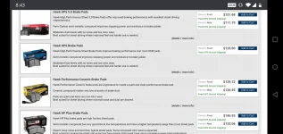

Looks like Hawk is now making both front and rear pads for our cars!
Specifically....
- Performance Ceramics
- HPS 5.0
- HP Plus
Nice. Wouldn't mind getting a set of HP+'s, I had those on my previous autocross car and I really liked them.
