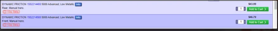

I believe you can get semi-metallic from a number of makers, if it's the semi-metallic nature of the pads doing the scraping, then I see no need to spend 440 for pads, these other semi-metallic options are like 60 -100 per axle.
^ yeah, rockauto list these "Dynamic Friction" hybrid metallic pads:
someone said they may not be a direct alternate to the OE euro pads. not sure. more digging would be needed.
the spider chart in the link above certainly seems to align with the performance benefits of the euro semi metallic. better than the regular ceramic pad at fade, friction, etc (i.e. the 'performance side of semi metallic), but the semi metallic create more dust and reduced rotor & pad life, which makes sense. also, this is why we don't have the same uneven pad deposit issue of the ceramic folks. gotta take the good with the bad.
If you think the only difference that makes the "Euro" brake pads better for hard use is the fact that they're semi metallic, and therefore makes the brake pads you listed comparable to them because of that, we need to have a more in depth discussion about brake pads.
With that said, the "Euro" brake pads are expensive, I'll admit that. There may be very similar performing brake pads at slightly less expensive price point, but I specifically wanted these pads for numerous reasons.
