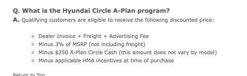

Don't forget to factor in Circle A Plan pricing from r_spec. Saved me a ton of money and time, since (at my dealer at least) there was no negotiation needed.
I’ll look into it. I thought that was for friends/family of Hyundai employees.

Look back through the purchasing/leasing threads, there is a member here (r_spec) who is a Hyundai employee and is giving our Circle plan certificates to forum members. Also, the 6MT is great, lots of threads on that too. (y)
If you can get one, the Circle A discount will get you about 7-8% off MSRP immediately just by presenting it and it can be combined with the lease cash incentive. I believe some people have said that they've negotiated further discounts in addition to the Circle A price, but not every dealer will probably be willing to go any lower. Even if you don't negotiate anymore below the Circle A price, it should still be a good price.

This thread has gotten massive hard to pick out the useful info. Goto to the top of page 26th. If r_spec is still helping with Circle A Certs.. he's easily helped dozens of people on this forum.
