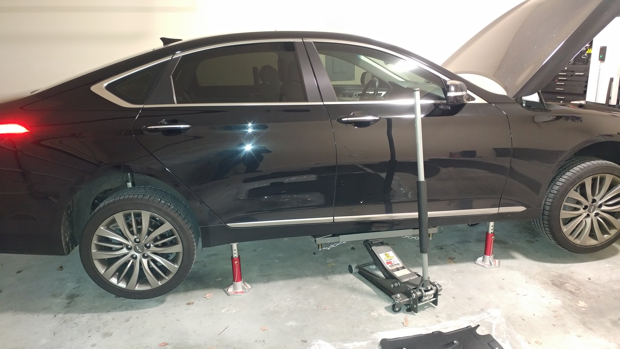

I have decided to purchase the 2018 G80 under-panels to make my oil changes easier on my 2015 Genesis 5.0. I will be changing my oil and transmission fluid soon, so I will install the new panels then since I have to remove both of the old panels to access the transmission pan anyway.
The new panels seem like they should fit, but I will not know until I actually bolt them on. I will also install a Fumoto F106S drain valve as well.

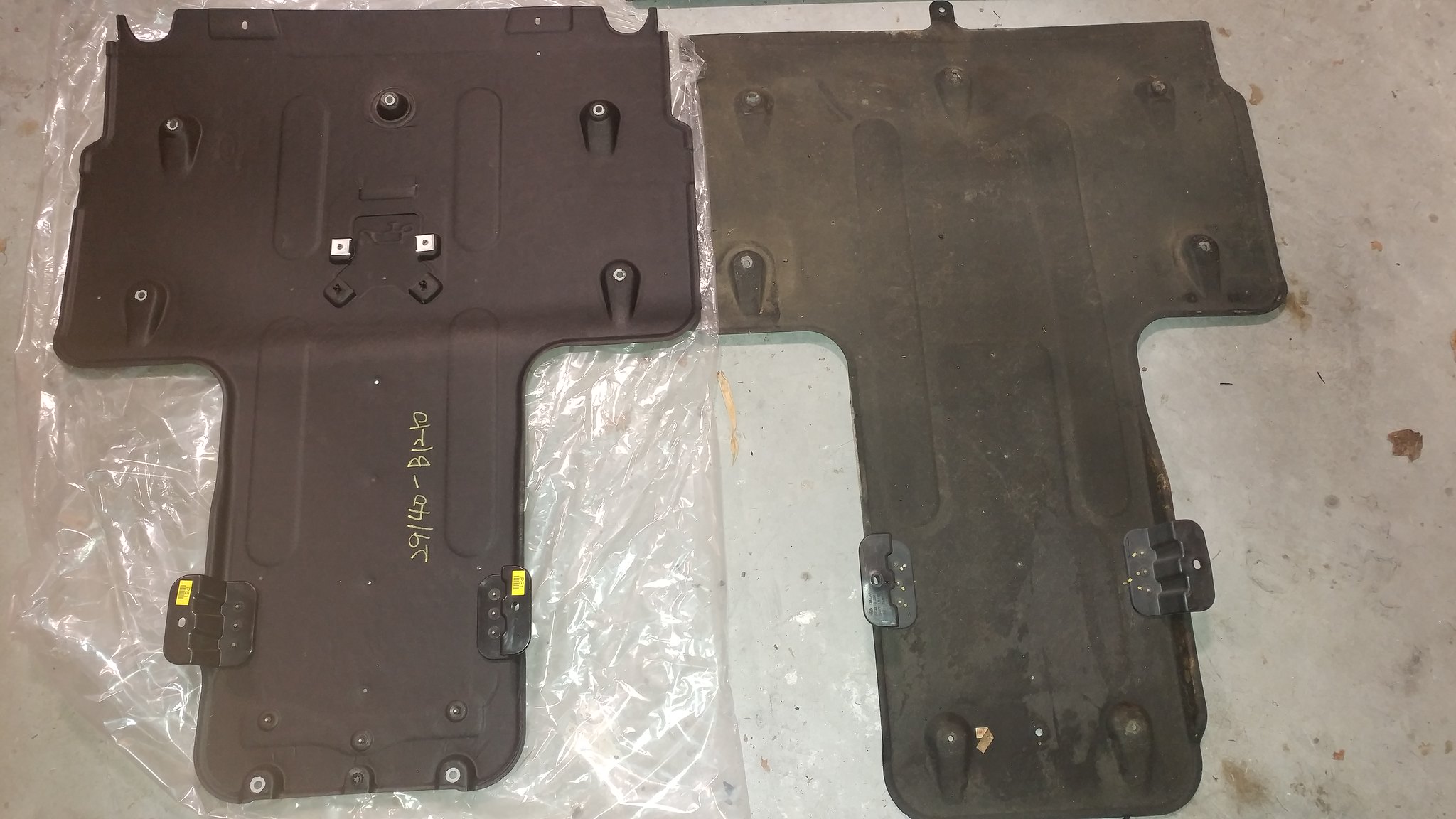

The G80 under-body panels with hatches for the drain plug and oil filter.

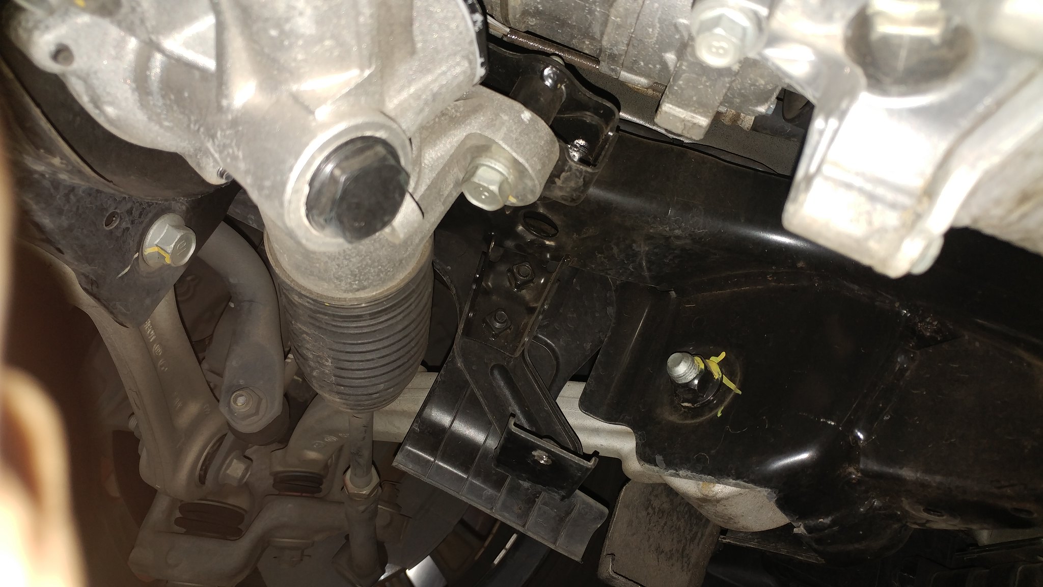

Went through a flooded street and now have a dragging front cover
I was reading through the posts - did anyone determine that the 2018 3.8 body panels would swap to the 2015?

Well, we've owned the 2015 5.0 long enough that I grew completely tired of taking those doggone underpanels off to change the filter and oil. A couple years ago I bought the manual top side tube down the dipstick holder method, and it works but 1) I still had to remove the front under cover to get to the filter and 2) I felt like I always left a quart plus of old oil in the car..
So..
I took the covers off a couple days ago and using the pics on page 1 of this thread, a ruler on the computer monitor screen and a little scaling math, figured out where to cut my own flaps. I used zip ties to hold the flap in place when it isn't open. Works!
Should have done this 100,000 miles ago!
