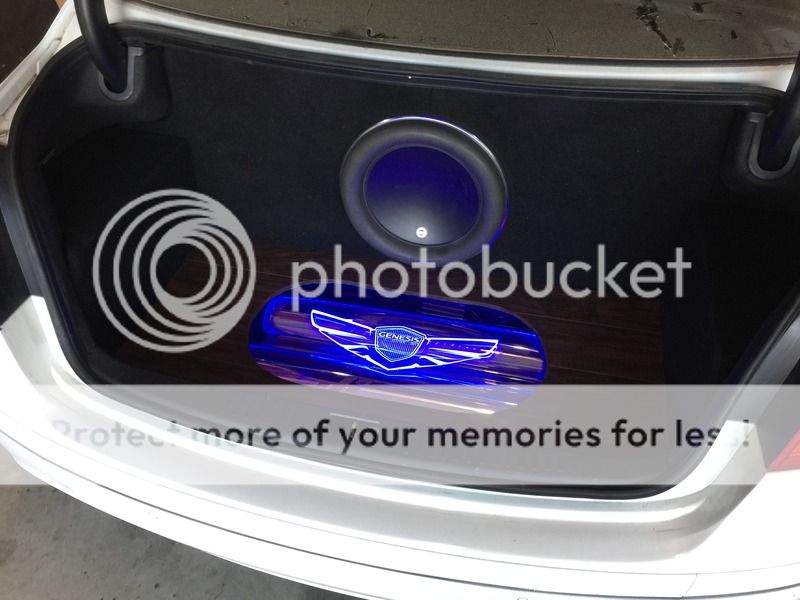

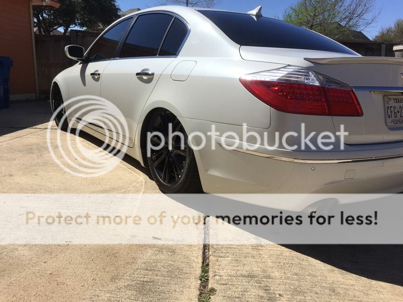

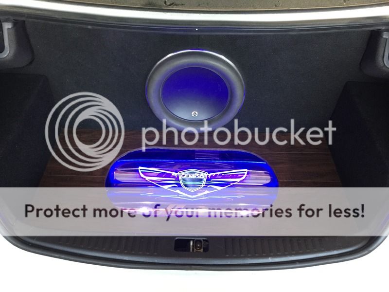

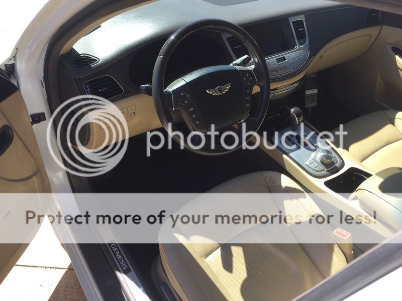

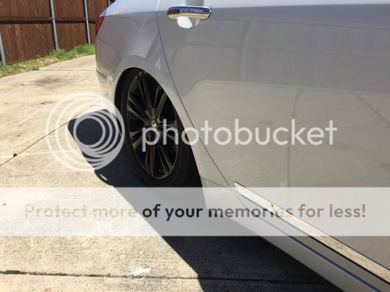

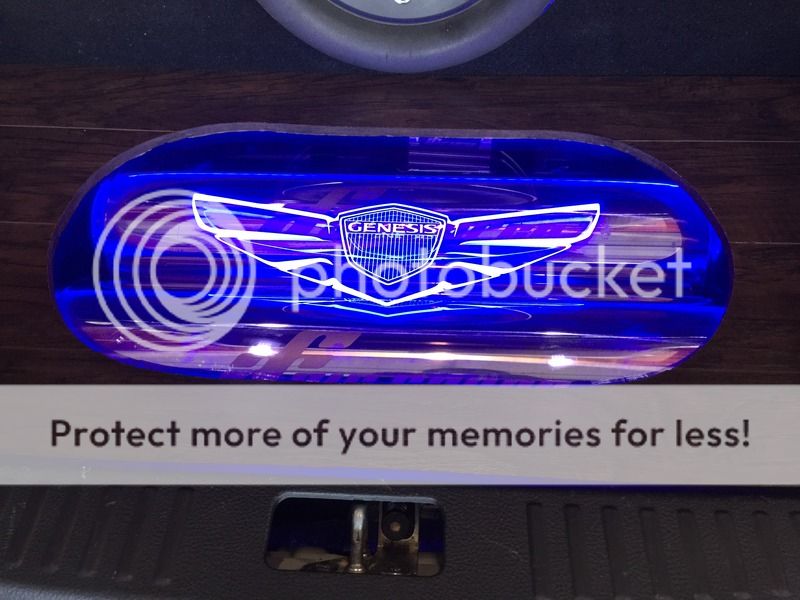

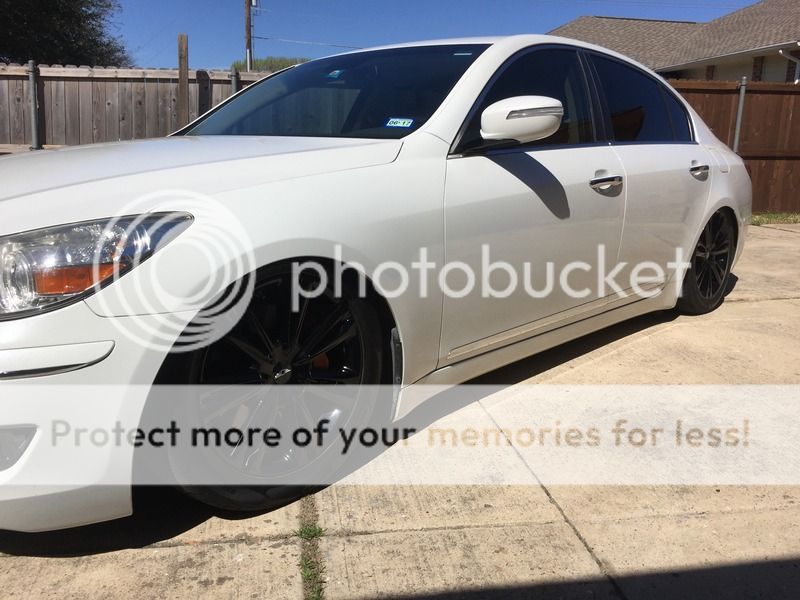

Glad you found the issue but sorry to hear that AirForce was no help in supporting the product. I only have AirForce bags and went with Accuair for management because of the fear for lack of support. Got any picks of your car aired out?
Well here it is. As you guys know, always a work in progress. These are the factory wheels for now.
