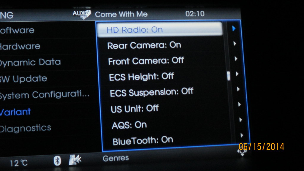

On my 2009 Tech in the engineering sub-menus (takes a special keystroke & button/DIS knob sequence to get in there - those menus are not meant for owners to access) there are what Hyundai calls "Variant" settings. These settings mostly depend on which country the car was sold in... things like air bag suspension or not, front camera or not, etc. On non-Tech cars only the dealer's plug-in system can access/alter the variant settings.

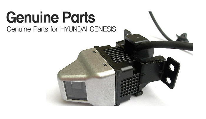

Front Camera Module
(http://www.ebay.ca/itm/300706937612?ssPageName=STRK:MEWAX:IT&_trksid=p3984.m1423.l2649)

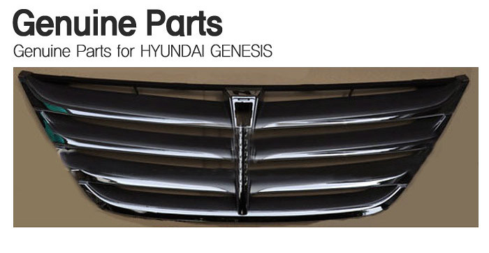

Front Camera Grille
(http://www.ebay.ca/itm/290708785795?ssPageName=STRK:MEWAX:IT&_trksid=p3984.m1423.l2649)

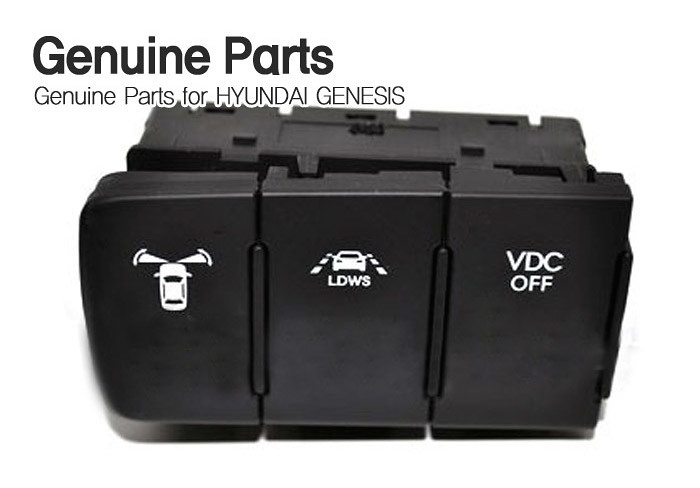

Front Camera Control Switch Module
(http://www.ebay.ca/itm/300706943118?ssPageName=STRK:MEWAX:IT&_trksid=p3984.m1423.l2649)
Turn Front Camera On from the engineering menu:
Anyone brave enough can try this and report back with the results!
