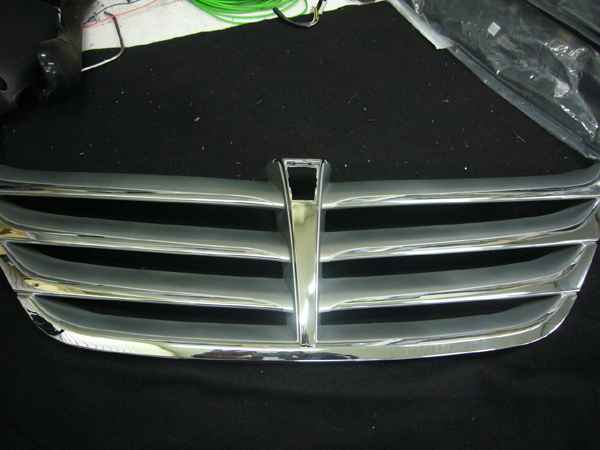

if we can confirm wiring ill order the camera and grille. should just be one plug?

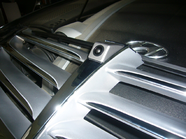

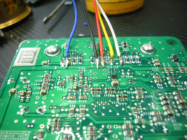

I'm looking into it on the Korean boards. I am a Korean citizen but have lived in Canada my entire life so it's still rusty. Better than nothing. Here are some pictures I found that may assist others.
After seeing this picture in the words of Shark Tank "I'm out"
If it's true plug and play I'll consider but no splicing/soldering/etc to a new car.

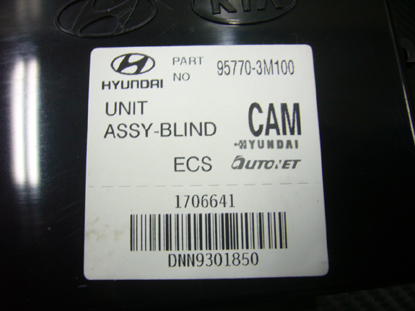

if thats a factory part, why would we have solder it? that part is 300 btw. just checked its a rear cam/blind spot module
That picture didn't have a description on the page I found it on so we'll have to see. I doubt soldering is req'd as from what I've read on Korean boards is that they're just plug and play + eng. menu.

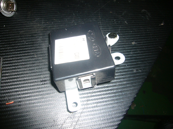

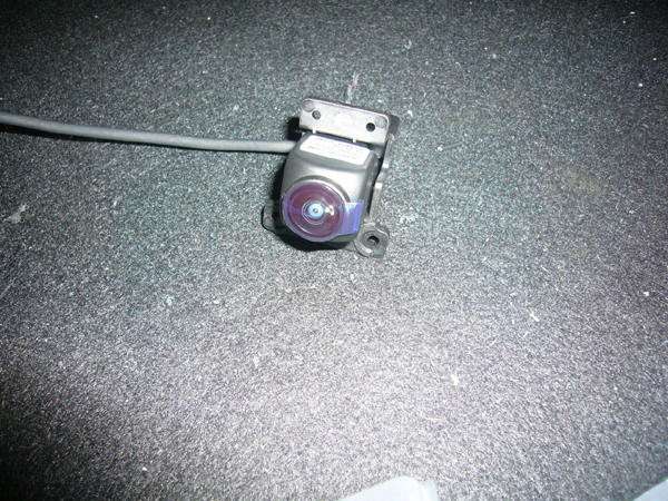

So i think we are one step closer. I pulled my trunk apart and got the module out. Where they soldered the wires are empty spots on the plug so that is the correct placement but i don't know why the soldered them. Now that being said, we know there is a switch on the dash we need, but what plugs in there? Where does the camera go? To the switch? And then the module? We just need to know what the missing link is. I doubt the camera runs all the way to the trunk.
if you have a v8 that won't work because the button are different, but since they all have a switch i assume we have to have it. but what else is there besides camera and switch? is there another harness to take it to the module in back?
