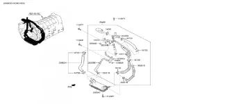

I got under my car and examined the transmission warmer. Did not see any sign of coolant leak. No liquid or dried blue/green residue at all for both the warmer itself and the lower portion of the 4 hoses attached to the warmer. I can't see the upper portion of the hoses where 1 of the 3 o-rings in the diagram is located. I was able to see the area where the other 2 o-rings are and this area is totally dry. This diagram is for 2018 G90 V8. The rectangular box at the bottom of the diagram with 4 fittings on top is the warmer. The hoses/fittings on top are the rest of the assembly. I can see 3 o-rings in this diagram and suspect the o-ring in question is the one in the upper area (97690B). The other 2 (97690A) are in the lower area which I can see in my car. I can't see the o-ring itself but I can see the metal structure that houses these 2 o-rings. In the pics, the smaller black box is the warmer. The much larger black box with multiple fins is the transmission fluid pan (made of composite material). As you can see, the warmer is located between the AT fluid pan and bell housing.
Wow, great post Vasy! Appreciate it!

About this defective o-ring in 5.0 engines, I think if you keep this car (V8 only) long enough the coolant leak will eventually happen, just a matter of time. Why? This o-ring is defective. They have an updated/improved o-ring to replace the original version. I have the 5.0 and I'll do my best to find this leak before warranty expires. I always carry a gallon of diluted Hyundai coolant in my trunk when I take this car for a road trip even before learning about this issue. From pictures in the TSB, slowly leaked coolant (greenish color on the recessed aluminum engine part) stays on the top of the engine due to the recessed contour structure. So it won't drip down to the lower part of the car and to the garage floor where we can spot. Even if it does drip down, the coolant will stay on the plastic bottom cover instead of getting to the floor for us to see. So all 5.0 owners should check coolant level on a regular basis and hope this problem does happen to our cars before warranty runs out. Don't hope it won't happen because most likely it will, eventually.
