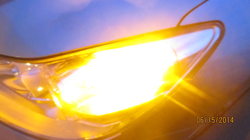

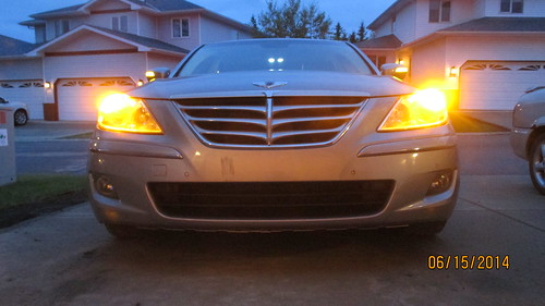

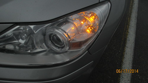

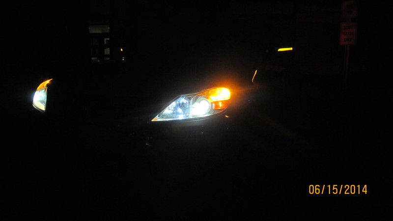

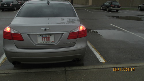

The turn signals of my Genesis were replaced with XP80 bulbs from Diode Dynamics.
They were $90.00/each for the front + rear pairs.
Fronts LEDs:

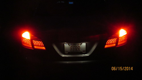

Rear LEDs:
I decided to opt for the Red LEDs as most luxury vehicles use red for the rear and amber for the front.

Wedge bulbs weren't bad. I had to ask a friend to install the front turn signal bulbs.

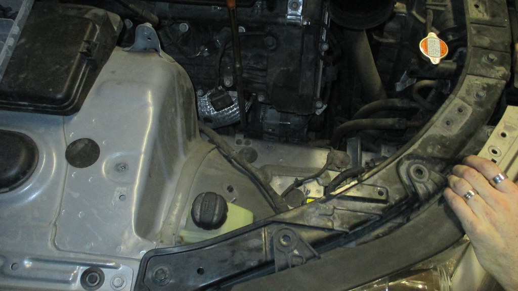

Removed airbox

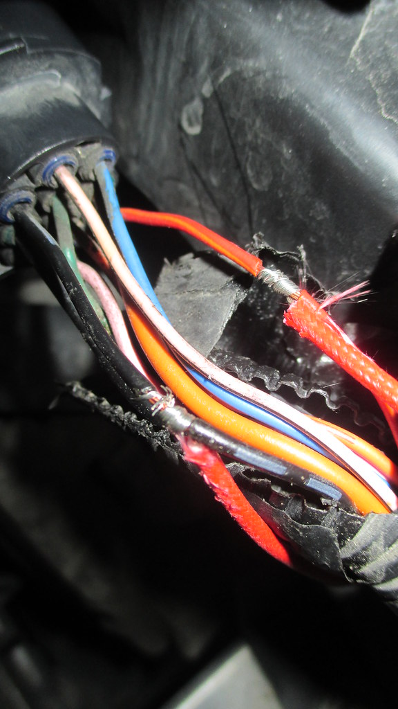

Picture of the wiring harness
Measured the voltage of the wires
Tester installed
Do not have pictures but they have been soldered on (no crimping here) and properly insulated.
The only thing stopping me from installing LED indicators is that the yellow color easily gets washed out in daylight. I am thinking the red indicators work great day or night.
how is visibility during daylight operations?
Brighter than I expected. Does not wash out. The oem bulbs tend to wash out more than the ones I've installed.

Okay, update to this. Tried installing resistors to another 2009 4.6 Sedan but the wiring colours were all off.
The below is for the front turn signals. Should be doing the rears sometime next week so will report back.
You have to splice the resistors into the Top right and bottom left (If you are looking from the back where the wires come out) (Black and Red on the photo) to stop it from hyperflashing
20950
Update 2:
Front Driver-side
-Red dot is the Blue wire with orange stripe.
- Black dot is the black wire.
Front Passenger-side
- Red dot is the red wire with orange stripe
Rear is simple. There is only 2 wires so just splice into each one of them and you're set.
