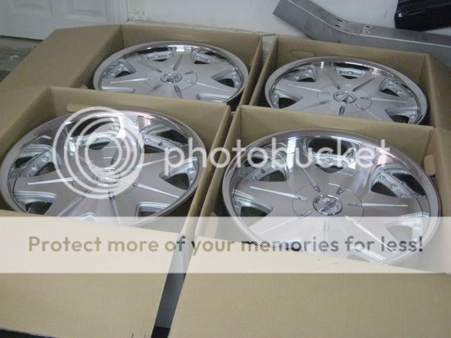

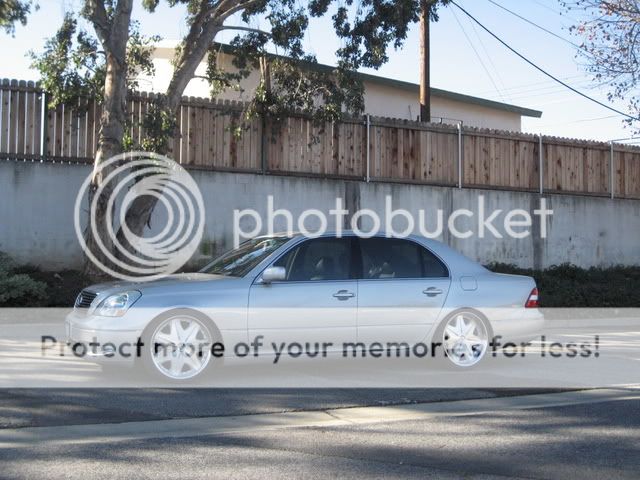

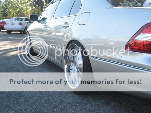

Are your wheels flushed with the fenders? I'm about to pick up a nice set of VIP JDM wheels for the genesis, that hasn't even arrived yet. The offsets are kind of agressive though, 20x8.5 +22 20x10.5 +27. I'm going to lower the car so the wheels should cambered in a little.

OMG!! The tires are way to skinny for the wheels! Not only does this look wacky, but the wheels would get scratched so much easier.
I hope you're looking into wider tires.......................JMO

The tires are pretty much flush in the rear with the fender, there is clearance, but not too much wiggle room. The front is tucked in a little as the wheels and tires are less wide.
I really do not know that this offset will work, and unfortunately do not know what lowering will do for them.

Thanks, from your information, I could go with smaller offsets for 8.5 wide in the front then. For the rear I'll go with lower offsets too so the wheel stick out alittle bit more at stock height. When I lower the car, the top of the tire should tuck under the fender as the rear wheels cambered inward at the top

You really nailed it with the Snettertons and the size tires you chose. That car has a killer stance. How do the 35 aspect ratio rear tires feel going over bumps? As to the other wheels. The 20x8.5 +22 will stick out slightly less than 3/4" further than the Snettertons(1 3/16" farther out than stock) and the rear will protrude slightly more than 3/4" farther out(2 3/16" farther than stock). Judging from the picture I don't think they will fit properly. For the 10.5" rears you will need at least a 285 cross section to prevent driving on the sidewalls as pictured on the Lexus, a very unsafe condition. That will also compound the fitment issue. I would test fit the wheels without tires first so to avoid damage and check all clearances. You generally can't return wheels once you mount tires on them. This will widen the track about 1.5" front and rear over the Snettertons and considerably more over stock, and will produce more negative camber due to the fact that reduced offset will act to increase leverage on the unsprung parts of the suspension. If there are problems in the front they will manifest themselves as a tire rub with the outside of the tire rubbing at full steering lock and fender rub at full compression. At the rear the fender lips will almost surely rub with small compression. When I had the GTO we could roll the fender lips up to gain that clearance but the Genesis has no flange to roll so what you see is what you got. In all cases good luck, I hope it works out for you.
