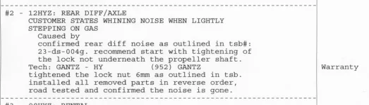

Just saw this thread, and I had the issue as well. There's a TSB for it. I had the fix 3K miles ago and so far still perfect. Image attached...

I hear a lot about the TSB - which I also had them address, but I still had another rear diff go since they did that, so it isn't a fix. They admitted they don't have a fix...and don't appear to be working on one.
I had to have the bolt tightened for the second time when I just went in for my 3rd oil change last week.

I also have about 19k on my 23 GV70 2.5t Prestige. My rear diff was replaced and then the issue eventually came back again. The second time there was a service bulletin that had them do some adjustments instead of replacing. Surprisingly they worked and it’s been a while (knock on wood) and it hasn’t returned. I had asked previously what would happen if not fixed and they said it would continue to get louder and louder. You may want to see if they can try the steps on the bulletin.
Thanks for the info on the service bulletin. Can you share the details of the bulletin? I had read in this forum that tightening of one of the nuts in the Rear Differential was tried.
I think someone had posted the actual bulletin on this forum somewhere, but from what I recall it was mainly about tightening a certain bolt to a specific torque. The dealer should be able to find it. I was very doubtful that it would work given my laundry list of other reoccurring issues, but it surprisingly worked and it’s been a while.

Just got my 22 GV70 2.5t back finally after 2 weeks at the dealer for my second attempt at fixing the Rear Differential hum. First time they replaced the Rear Differential unit, this time following a TSB, they replaced some bolts. Only time will tell if this fix works.
