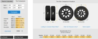

According to tiresize.com/calculator a 40 sidewall will be 2.7% larger in radius than what the car is set for.
Difference is negligible really...
