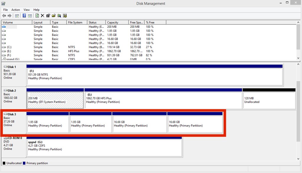

Yes, as long as it's a physical cloner. It should be fine. All partitions need to be cloned as well. There are 4 partitions in total. 2 small ones (around 1.5GB) and 2 bigger ones (around 15GB).
windows can't read? and 4 partitions? boot swap usr and ... data? sounds like a linux box. now i'm curious. :confused:

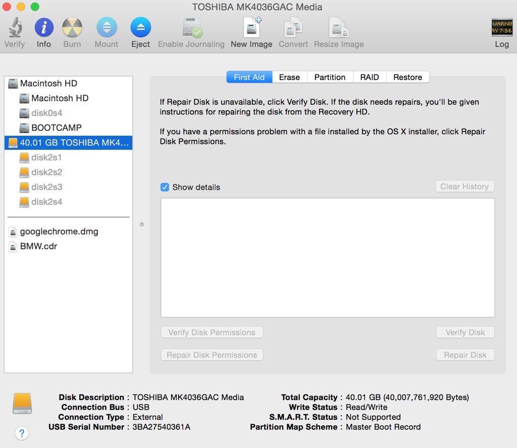

It will show as 4 partitions and Windows can not tell what type format the drive is in. You can not actually access the drive from Windows (Attempted on Windows 8.1). Haven't tried Mac yet.
Lmk if you can read them on mac. I have win 7 8.1 and OSx. The only thing I dont have is a linux box...which is what this does sounds like. So for $150 and some time, I can get a quicker infotainment setup??

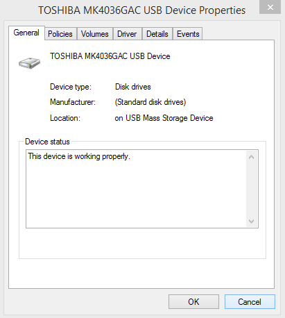

Windows 8.1
Devices Properties
Mac OS X Yosemite
