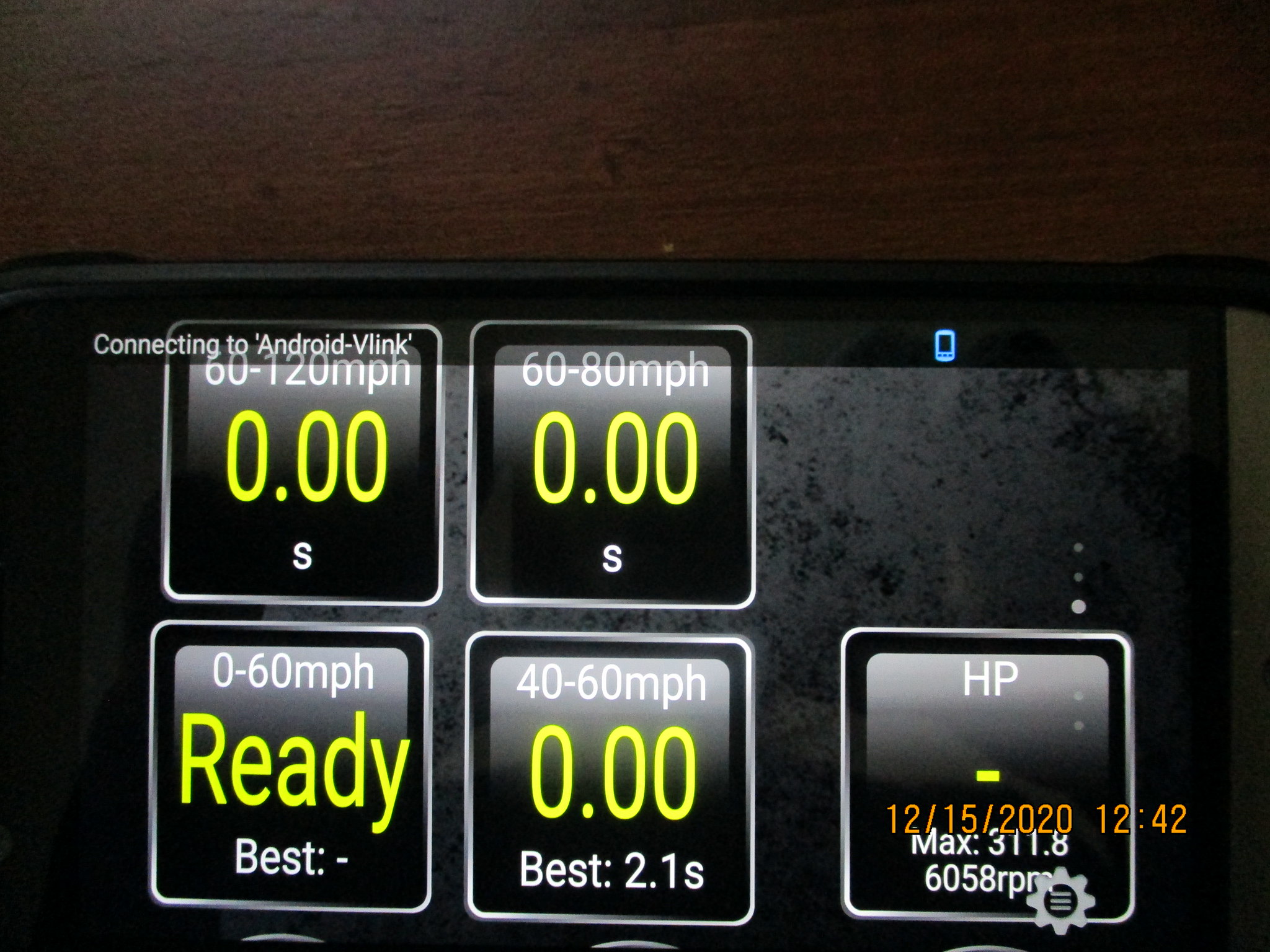

My best time over the Spring or summer. No time stamp, however it was before the coolant bypass mod. The intake temps were over 132F.
My intake temps today at 78F. My tablet is toast so I cannot get a good GPS lock with my phone so my 0-60 times are very inaccurate due to losing the GPS satellite where I do my 0-60 runs. The Torque app only gives me a 40-60mph time with my phone which is 2.1 seconds.
