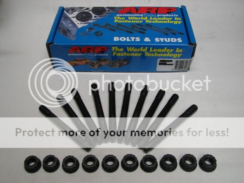

6. ARP head stud kit, 4B11T part

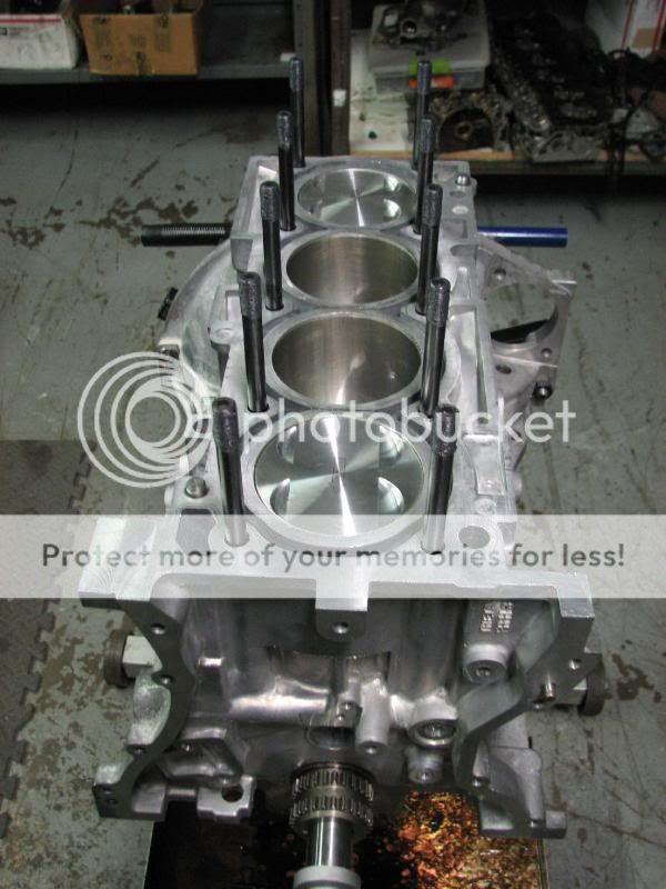

1. Block bore/hone to 86.5mm

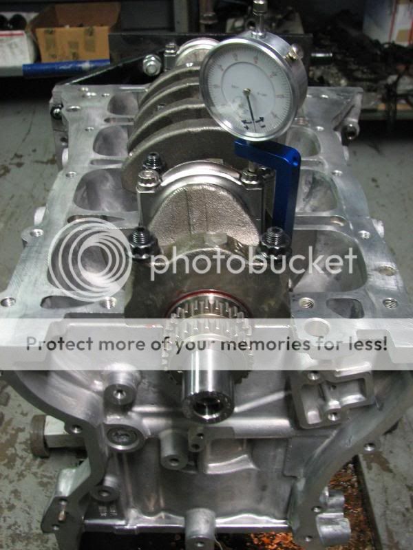

3. Balance and polish crankshaft

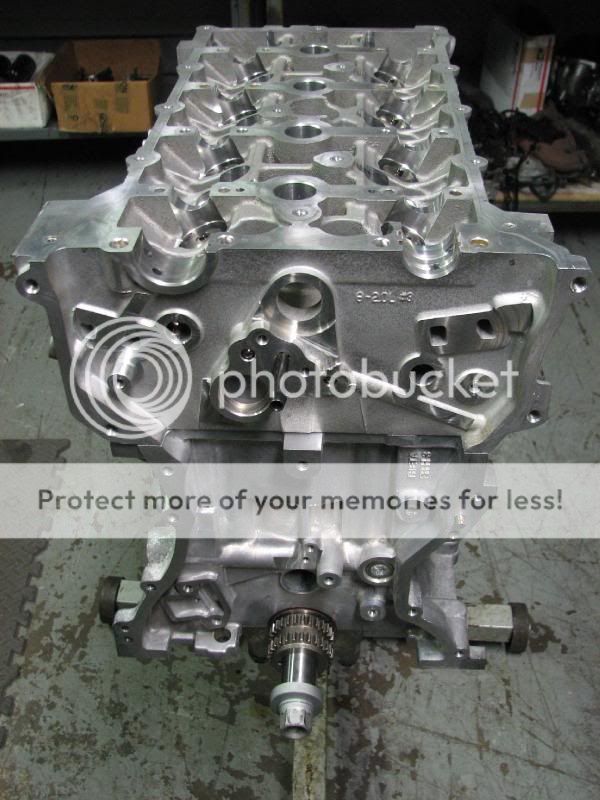

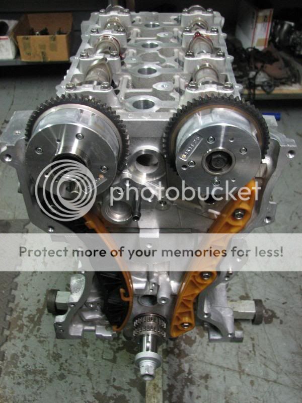

•Cylinder head- Excellent design of the head. Direct bucket over valve design unlike 4G63 which was a roller rocker design. 4B11T uses very thin 5.5mm stems on the intake and exhaust valves. 4G63 used 6.5mm stems on intake and exhaust. 4B11T uses very light weight shimless buckets. Intake and exhaust camshaft use an oil pressure controlled vain-type variable valve control system. Early 4G63 had no MIVEC system and late 4G63 only had MIVEC on intake camshaft. 4B11T camshafts are chain driven versus belt drive of the 4G63. Single valve springs utilized in the 4B11T.

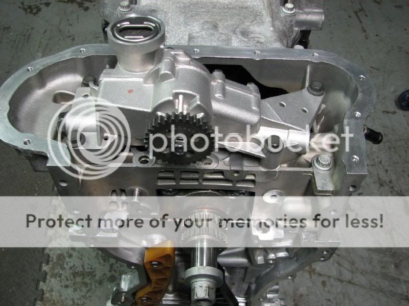

•Oil pump- Oil pump is mounted on the bottom of the upper oil pan girdle and chain driven off the front of the crankshaft. Oil pump is a gear-rotor design with a single stage for pressure. 4G63 used a spur gear style oil pump driven by the timing belt as an auxiliary item.

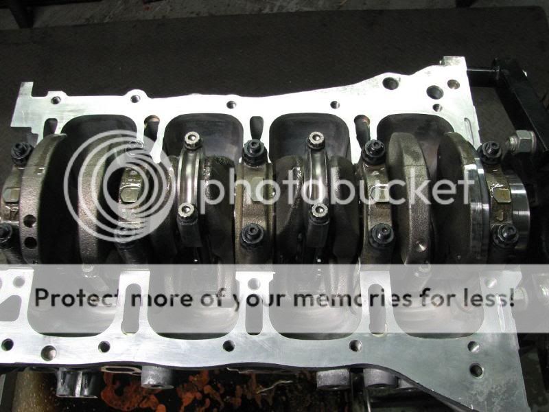

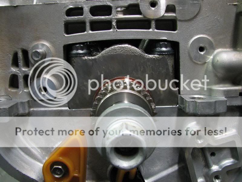

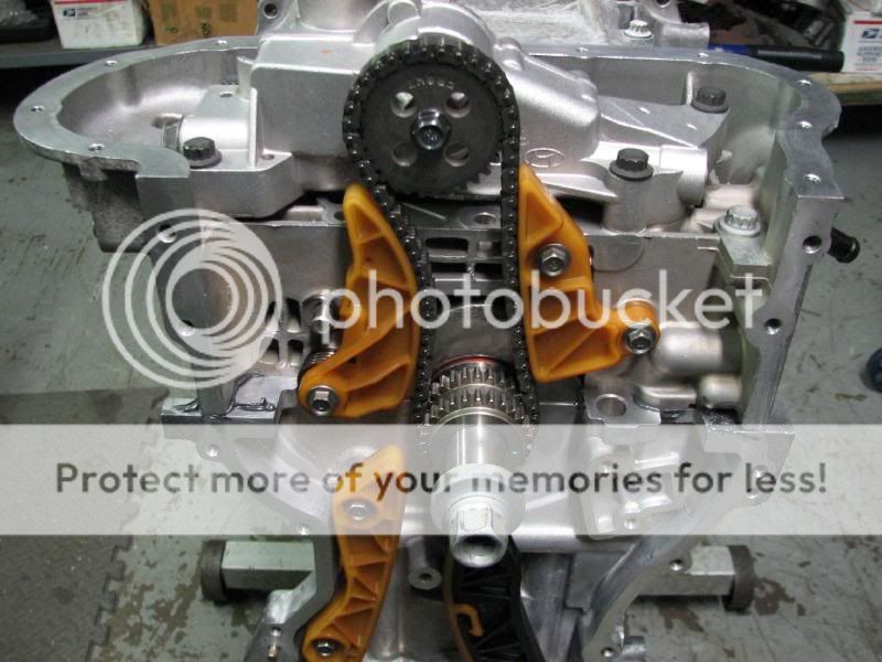

•Crankshaft- Crankshaft is forged. It uses smaller rod and main journals than the EVO 10 4B11T version. Rear of the crankshaft has provision for crankshaft position reluctor wheel, which is used by the Mitsubishi 4B11T. Hyundai engine uses the flywheel for crankshaft position. Since the rear of the crankshaft has provisions for the timing sprocket but does not use it, the crankshaft is actually out of balance. The front of the crankshaft was within 2 grams, while the rear was off by 10.5g. This required extensive drilling of the counterweight to correct out of balance. This out of balance can be detrimental to engine bearing life due to crankshaft flex at high engine rpm.

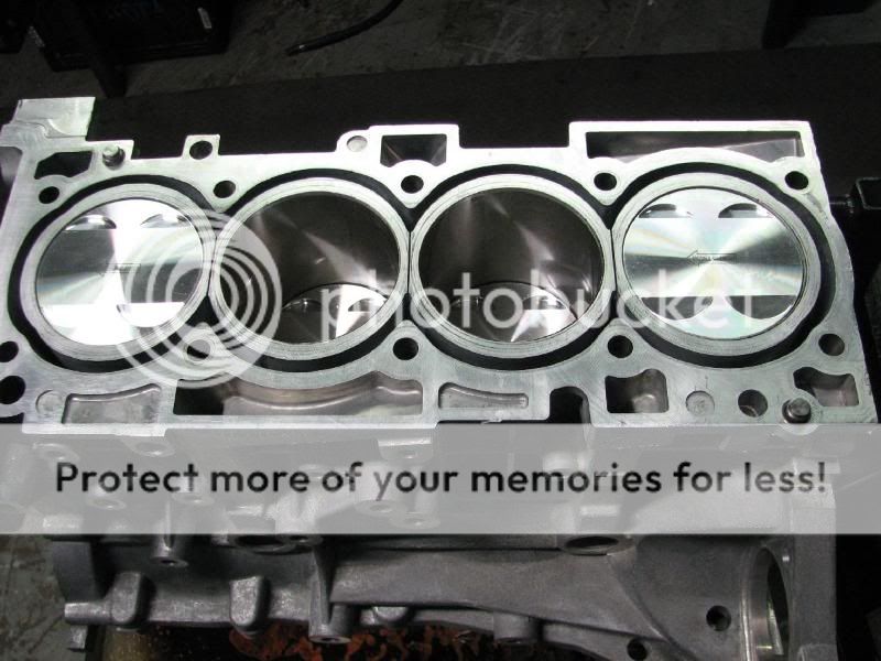

•Pistons- Pistons are cast aluminum using thin, performance-style rings. Stock pistons use a Teflon type of friction coating on the skirts.

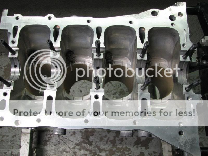

Engine block cylinders bored/honed to 86.5mm size and crankshaft main journals align honed with ARP main studs. Custom ARP main stud kit was made for this application. Four of the ten main studs were shortened to clear the upper oil pan.

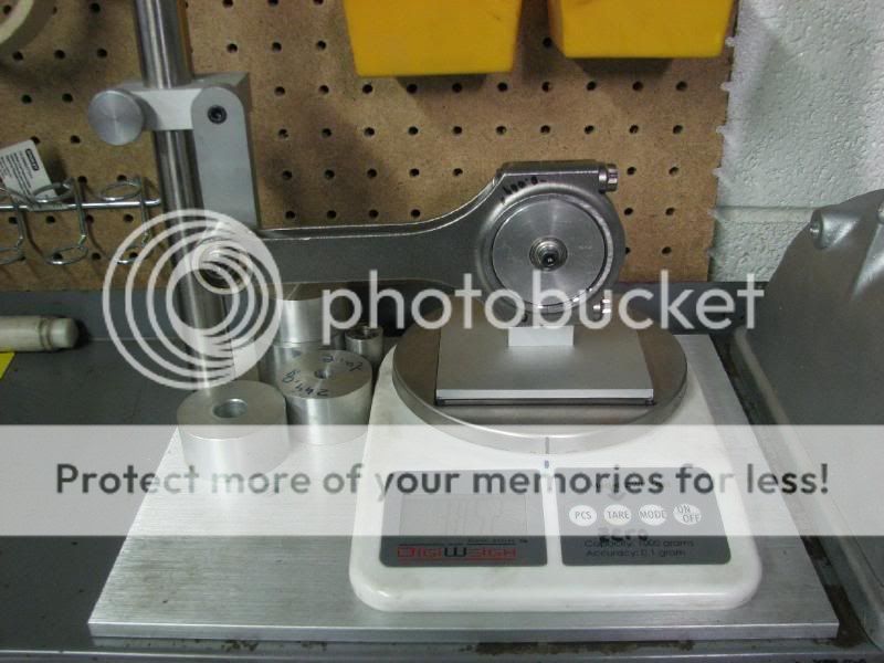

Crankshaft polished and balance. Connecting rods and pistons weight matched. Manley pistons specification sheet stated piston weight between 333 to 334 grams. Piston weight measured on the precision scale read between 334.0 to 334.7 grams. All pistons were matched in weight. All pistons weight-matched to within 0.1 grams.
Connecting rods from K1 Technologies, a partner of Wiseco, are made in China similar to Eagle rods and use the same ARP 2000 3/8” thread 1.600” length bolts. All connecting rod weights were checked on the small and big end using a precision connecting rod scale. After confirming weights, the rods were matched on the small and big end, and confirmed as a whole. All connecting rod were weight-matched to within 0.1 grams.
Polished and balanced crankshaft, Manley forged pistons, K1 Tech rods with bolts, and ACL performance rod bearings.

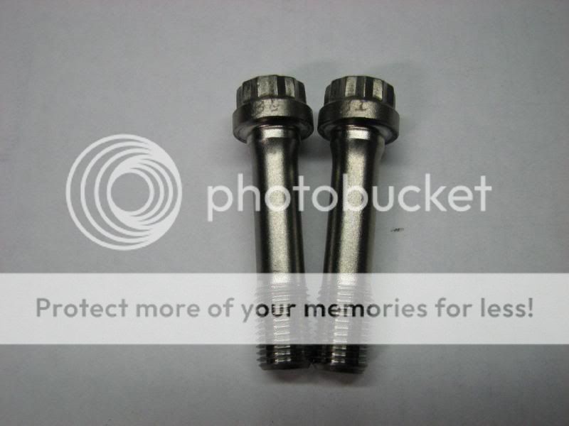

Each connecting rod bolt is labeled using an engraver. Each bolt is measured and its length is recorded. During engine rebuild process connecting rod bolt length is recorded and compared to previous notes made. If connecting rod bolt length changes by more than 0.001” inch, then the bolt requires replacement. Connecting rod bolt is the most stressed component in the engine. Monitoring its size and condition can mean a difference between replacement of a $6 bolt or catastrophic engine failure.
Pistons installed
Connecting rod bolts tightened using a rod bolt stretch gauge. This is the most accurate method of tightening bolts. This method does not require any special lubricant. Stretch is a state that is measured via the dial indicator. This is more accurate than a torque method because torque method measures the friction in the thread. If improper lubricant is used then reading will not be accurate.

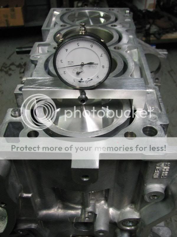

Cylinder 1 TDC is found using a bridge with a Mitutoyo dial indicator that reads in 0.0001” inch accuracy.

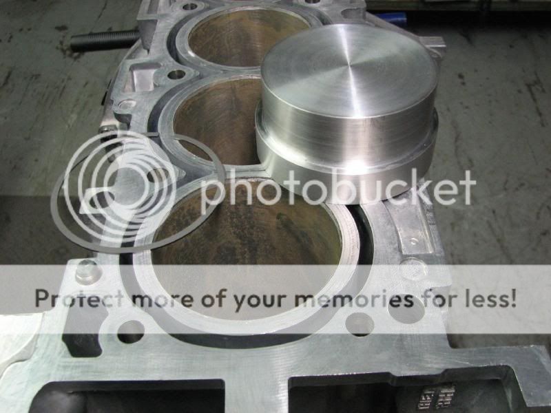

After TDC is established the piston dish volume can be measured. A clear acrylic plate is placed over the cylinder and a precision volume burette with colored alcohol fluid used to check piston dish volume.
ARP cylinder head stud kit installed into the block using ARP Ultra Torque moly lube.

Pistons installed
