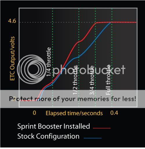

Anyone seen/used this gadget?
Seems to me that in 4/10ths of a sec, 'if' this gadget worked as described, you might get 1/10th better response?
Seems negligible for the $.

That graph is misleading with time shown on the axis. The Sprint Booster can not effect anything related to time. All it does is increase the throttle output per pedal movement, effectively lowering the resolution of the pedal so that 3/4th throttle is equal to full throttle and the last 1/4 throttle does nothing. It does not make the car accelerate any faster. You can do the exact same thing by pushing the throttle further yourself.

To be clear, the Sprint Booster doesn't make the car any more responsive. It does make the throttle think that it is pressed in further than it is so 3/4 throttle acts like full throttle. You can do the same thing by just pushing the throttle in all the way.
What you lose is control. Small throttle movements now become greater throttle movements, and therefore adjusting small increments of throttle will be 25% more difficult.
IMHO, this is a bad thing...especially with the overactive ESC of the Genesis. In order to drive fast you need to meter the throttle carefully, or you will go into ESC protection mode where the computer throttles the engine back...actually making you go slower.

This device has an interesting idea to "boost" the responsiveness of an engine.
Afterall, the throttle IS restricted by ETC algorithm and the programming of how to apply the amount of gas pedal being pressed to the actual throttle opening is totally up to the manufacturer.
Disaster,
I hope the logic behind this "Sprintbooster" isn't as simple as multiplying the ETC output voltage by x amount of times and feeding it through the ECU.
If they're smart enough, they would've left the minimal throttle input(say, 1/32 or 1/16 throttle) very close to stock output, and boosted up the mid-throttle quite a bit and then gradually taper off towards full-throttle.
At least that's what I would've done if I were to calibrate this device.

Well, basically it looks like they just used the volts map and the 'feel' to come up with a new acceleration curve.
Electronically that seems pretty straight forward.
I agree with the idea that you might lose low down throttle sensitivity.
