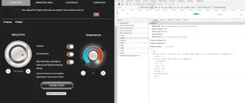

What I'm asking is if someone can go to the website, open the console view, and post what the command sent is in the networking tab when starting the car with all possible options to help me include these options in my script. You can find that by:
  1. Go to the genesisconnect website
  2. Click f12 on the keyboard
  3. Go to the "Network" tab
  4. Back on the webpage, choose all the settings
  5. Click the "Engine Start" button
  6. Back on the network tab, an entry with the name "rmtstrt" will show up, click on it
  7. Click on the headers tab
  8. Collapse all the response and request headers
  9. Expand all request payload
It should look like below. Be aware this will send the command and start your car (if you don't want that, you can disconnect from the internet before clicking "Engine Start" to show the command but prevent it from going through). Make sure to remove your pin and remote address from the screenshots before posting.

Thank you! Yes, there are 2 calls to make, 1 to authenticate the login info and get the auth key, and the second uses the auth key plus PIN to request the remote start with the included parameters. That's what you see in the screenshot above. Also please make sure to collapse the Request and Response header fields and hide your IP and PIN in the screenshot.

On my setup (USA G80) I'm not getting the "rmtstrt" entry. Below is remoteAction.

Here's mine
Sorry, realized you wanted it with all options selected. Another photo attached.
