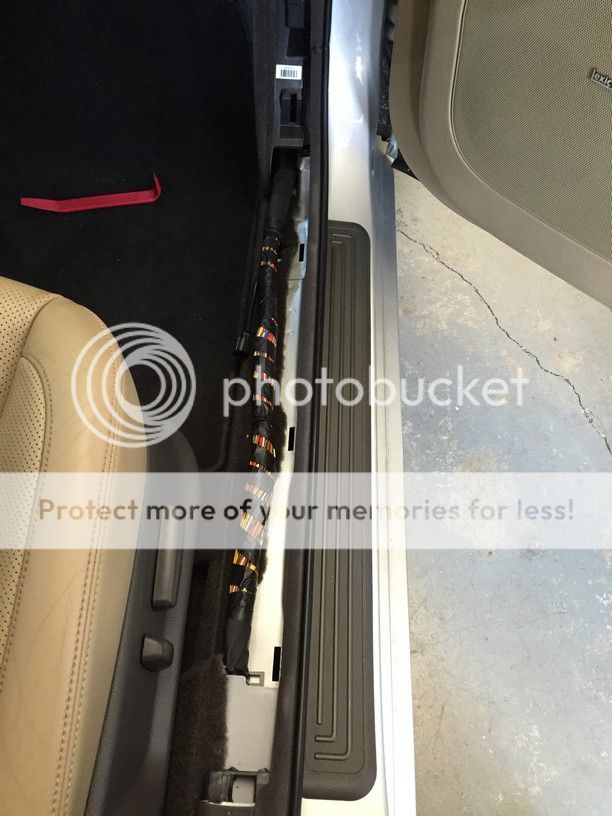

I replaced my sills on my V6. The wiring harness does have the connectors, and the new units replace the entire scuff plate, not just the metal plates. Installation is simple - just use a broad blade flat screwdriver to carefully prise up the existing units, connect the harness connector (it's taped down to the harness, so break the tape) and press the new sill into place.
There are pictures in the photo gallery from another member.

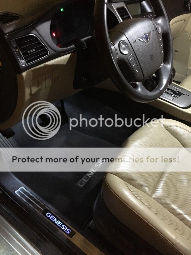

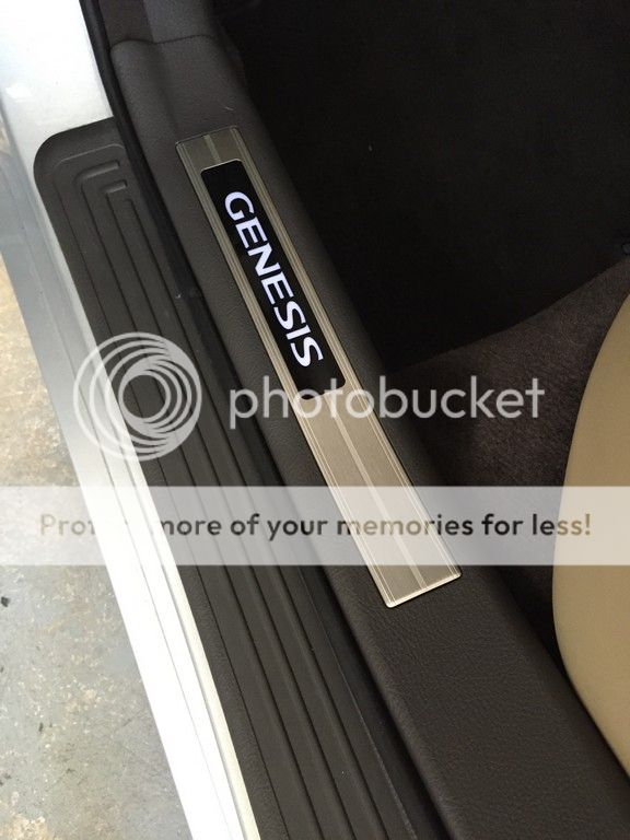

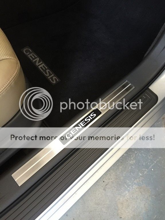

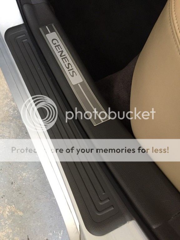

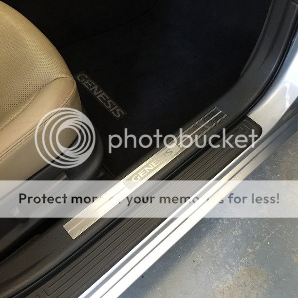

You can see the subtle difference in color here. LED Black scuff on left, non LED brown/cashmere on the right:

Going an answer to my question with help from Jei over at KDM Motors and interior/exterior color code chart found on this forum. Should have looked it up before ordering but I didn't. Color Codes for Genesis
The "RY" and "BR" are both black but deal with different manufacturing dates.
"RY" are black manufactured after Feb 2011.
"BR" are black manufactured before April 2012.
Based on a interior/exterior color code chart I found "M5" is for beige/grey. Numbers below are what you need for cashmere interior. Just went up on the marketplace LED Illuminated Scuff Plates aka Door Sills - Full Set - Black

Interesting photo above. I have the cashmere interior with the dark brown cocoa carpeting. My OEM, but add-on, sills are black, not light beige, around the Genesis name. ????
Funny, I recall a guy here about two years ago telling me that he had black carpeting in his cashmere interior. He just wouldn't believe me that it was dark cocoa brown.
