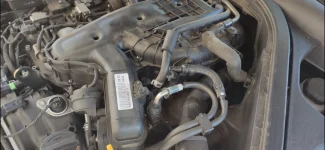

These 3.8 engines have no maf sensor so you can probably blow the CRC into any hose that sucks. Probably the same with the V8. I used the hose that runs across the top of the manifold based on the suction, access convenience and the point at which this hose enters the manifold; past the larger air ducts. The metal nipple below did not suck so it's downstream of the intake and no vacuum.
I ran a can of CRC today:
1) Detach the vacuum hose right behind the metal hose. Simply squeeze the hose clamp and pull up while twisting left and right and it comes right off. The black nipple to which the hose is attached is about an inch long. To reattach, you simply squeeze the clamp and push it back into the attachment nipple.
2) Start the car and you will be able to feel the suction from the hose. I spayed the CRC intake cleaner in short bursts per the directions on the can.
No CEL or white smoke, or any other issues when starting the car after an hour. It did smell like rotten eggs halfway through the can. And it felt a little sluggish pulling out of the driveway but otherwise fine.
There's a noticeble improvement in idle. No more vibrations while in D, so I'm really happy with the outcome.

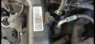

No, not the metal tube with the 90% bend. The hose I used is the one behind your red arrow. I believe this is the vacuum hose between the brake booster nipple and the intake manifold. It runs across the top of the intake. I should have taken the picture while the hose was off.
I disconnected this hose by loosening the clamp and pulling the hose up off the rigid nipple below it, and up away from the manifold top. I then inserted the CRC can's plastic straw nozzle into the hose leading to the manifold. The vacuum suction is quite strong and sucks the stuff in well. Takes a while, i'd say close to 10 minutes to suck in the whole can. My son was in the car keeping the throttle at 2,000 rpm, and not more than 3,500 rpm per the instructions. Then a couple of revs up to 3500 rpm, and it sat for an hour. Went for a spirited drive; not fast but higher rpm in lower gears. Not much smoke came out although did get some carbon discoloration on the exhaust tips which is expected. There are YouTube videos on this process but with other cars like a Veloster.
There are other vacuum hoses you can use but this one is convenient and enters the intake manifold downstream of a bunch of stuff. I plan on doing this every other oil change. Should help reduce carbon buildup.
