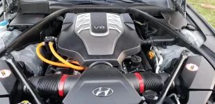

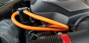

If you buy the Mishimoto baffled catch can from amazon, DO NOT buy the hose that Amazon recommends. Its too small for the car and the catch can fittings. Fortunately, I had some vacuum hose laying around... Unfortunately, its orange. I ordered some more black.
