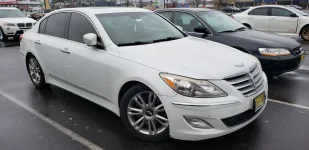

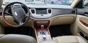

Car is in great shape and rides great. No accidents, dents or dings, few scratches. Very little wear in the interior. Im the 3rd owner. Previous owner had it for 5 years and put about 45,000 miles on it. He says that all maintenance has been done by dealer. For arguments sake, lets say it wasn't maintained by the dealer, what should I check and/or do? Would I be able to obtain a service history from Hyundai? Thanks
