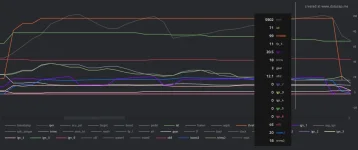

I did go DYNO the car last week before I left. When I pulled the AWD fuse out, I accidentally knocked the power wire to my charge pipe injection loose. So on the Dyno the fuel pump was crashing at 4k and above RPMs. Rookie mistake on my part and didn't realize it until I went to drive the car after and noticed my E85 gauge was only reading "E8". I knew instantly that my CPI and fuel-it sensor wasn't working cause it should say "E40"
Still made 469whp and 543wtq though
You can see on the dyno graph where the pump crashes after 4k RPM. Power just falls on its face. Then looking at the log (attached) you can see fuel trims went through the roof and the fuel pump crashed. I was running E40 so without CPI the HPFP can't keep up.
Without charge pipe injection or METH, the car still made that much power. Id be curious to see how it performs on just E30 without the CPI. The HPFP can handle up to E30 without crashing. Also curious to see how much more power it will make with my CPI working haha. Going to go back soon and do some test on the dyno. I was able to obtain a meth kit so going to do DYNO runs on meth/no CPI, CPI/no meth, both meth and CPI and straight E30 with no meth or CPI.
Needless to say the car performing better than it ever has, having LAP3 ECU and TCU.

The chart is showing the fuel pump crashing above 4k RPM because CPI wasn't on. If it was on, HP/TQ would hold closer to redline.
basically the chart above is worthless since the pump was crashing and fell on its face.

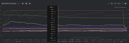

Alright. was able to do 5 back to back logs with the new meth kit installed.
In terms of the log, it is perfect. Not one thing out of place. 0 timing pull on all logs across the board and hitting 22 degrees of timing up top. AFR is spot on. Fuel trims are perfect. Boost stays flat at about 19-20psi through the gears. HPFP is not even close to being maxed out with E46 on CPI. IAT's are lower than normal. Its still 75-80's here so seeing IAT's in low 70's is a first. Once it gets colder I am sure they will drop more.
A lot more data to come. Going to get some logs today showing it without WMI and just CPI on E46. Then Once I get that, I will drop the car down to E30 and turn off CPI and run it with just meth spraying.

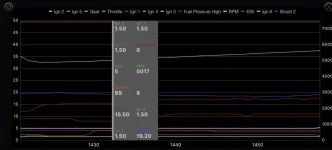

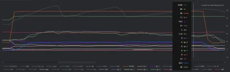

Here is a log with just CPI (E45) and no meth. Pretty much the same data as CPI w/ meth which I expected.
Also, was out and about and had to fill up with straight 91 octane (couldn't find E85). So attached is a log with just 91 octane and meth. Pretty good considering. few timing corrections but not bad at all with highest being 1.5 degree. Def feels a tad slower in the powerband with the overall timing being lower throughout. But the ECU is doing its job and adjusting.
Next logs will be E30 w/ meth. No CPI. Then E30 w/ CPI and no meth.
