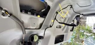

  3. Open the warning triangle holder (small plastic bracket in the top center of the trunk lid), and remove the single screw holding it in place. It hooks into the trunk using curved hooks at the end, as shown in the picture.

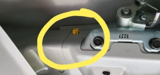

  5. There are two push pins located on the side of the plastic cover over each hinge, as shown in the picture. Press the center of the push pin in about 1/8", then pry out the pin.

  7. Gently pull the carpet away from the trunk lid. The handle and the plastic cover over the trunk latch should come out with the carpet, but you can remove them separately if desired. The trunk closing buttons remain installed, and the carpet flexes around them.

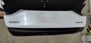

  9. Remove the three 10 mm nuts holding the body panel with the license plate. I removed the license plate, but I'm not sure if this is required. Gently pry the body panel away from the trunk lid. You'll feel the push pins give as you pry.

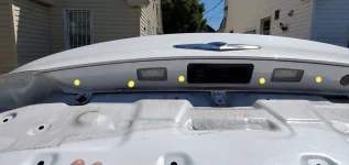

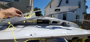

  10. Remove the four small Phillips screws in the yellow clips that hold the trim piece above the license plate where the lights are mounted. You can see two of them in the picture. The one on the left-hand side is hidden behind a round black component (possibly an actuator to open the trunk remotely). I did not remove it since I was replacing the right side light. I could flex the panel away to remove the light. If you need to replace the left side light, you may need to remove this component to access the screw.

Just finished mine; Gmason369 has it right: angry by the time I got he big panel off; broke 5 clips, bought all new, and then decided to use just 50% of them; that panel isn't going anywhere with 5 bolts securing it.
Like the others, I sacrificed the yellow clip with tiny Phillips screw on the far driver's end; necessary if you're replacing the driver's side light.
One other possibility: after removing all those tiny Phillips , I realized their yellow clips might come out without removing the Phillips.
I pulled all the yellow clips with the panel removed; turns out you can slip a 9mm open end wrench over them, from inside the trunk, to depress the side wings, and they will pop out; beware: they may go 10 feet!
Then it was much easier going back together to install the Phillips through the clips into the panel; easy to snap them all back in. Next time I'll try the 9mm trick before removing those tiny screws.
