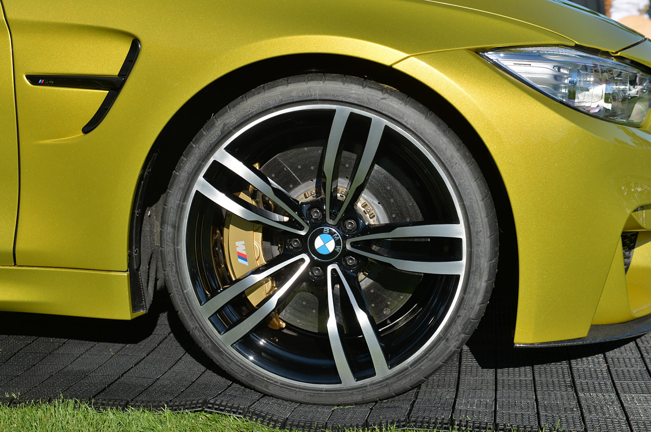

Anyone consider m4 wheels on a 2015 genesis? I think they will really set the car off.
I seriously doubt the bolt pattern would fit unless you are able to find some aftermarket copy cat wheels. Way to much disc/caliper showing on those without the car having the brake area designed to be seen which is not the case of the Genesis, especially in the rear. Plus the fact that a 1/2" of rubber on the road would suck big time.
They won't fit.
BMW: bolt pattern 5X120 hub bore 72.56
Hyundai Genesis: bolt pattern 5x114.3 hub bore 67.1
