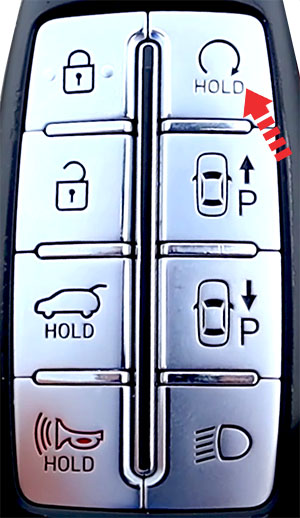

Maybe they are suggesting to use the remote start feature using your key fob?
Remote start procedure for GV70​
You can remotely start your Genesis GV70 by following these simple steps:
  1. Press the LOCK button on the key fob of your GV70.
  2. Then within 4 seconds press and hold the REMOTE START button for over 2 seconds on the key fob.
  3. The engine starts and the turn signal lights flash multiple times.
  4. Once started remotely, the engine will run for 10 minutes and then shut down automatically.
The vehicle remains secured when you have remotely started the engine. A valid key must be inside the vehicle to be able to drive.
The remote start procedure must be performed within 32 feet or 10 meters distance from your GV70, otherwise the engine may not start. The range may be reduced due to weak battery in the key fob or external signal interference.
