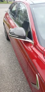

Alright took a while but it was finally done. Located a shop who was confident enough to tackle this job.
This is definitely beyond DIY, even as an electrical engineering taking this on myself would've been daunting for fear of breaking something and having to buy a whole another assemble roughly 1300 quoted by dealership.
Dunfab in NJ took on this task for about 4 hours. They knew right away they would have to depin every wire to get these caps off. Genesis also red loctite some of the Phillip's head. Heating up the screws with a soldering iron did not help and the heads snapped and ended up being replaced.
Those were the major obstacles required to get the OEM caps off. Reassembly requires less effort still requires you to put all the pins back in the correct spots.
TLDR: Thanks to Dunfab motorsports. Genesis makes it a super pain in the ass to replace caps. Dealership would not take on this job

Finally got my mirrors replaced with the carbon fiber versions. I didn't even try to do on my own but have a custom shop do it for me as the electrical work is complicated. I had Elite Motorsports in Long Island do this.
See pics attached. Came out amazing.
