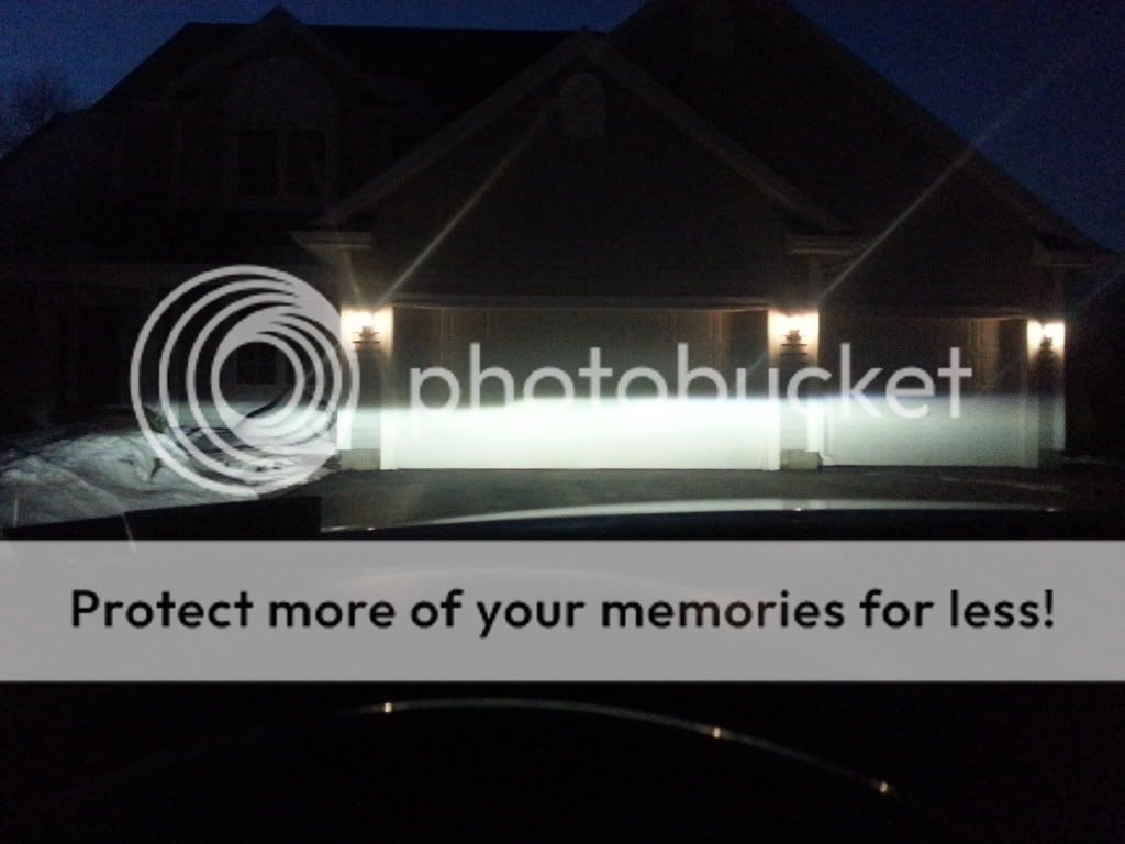

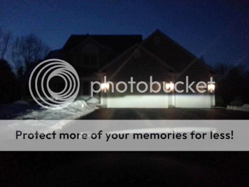

Thanks! I have my pic taken all ready haha
What angles do you have for pics? Dead on, and maybe a side shot?
Took my pic sitting in the driver seat against a white garage door from about 30' away
