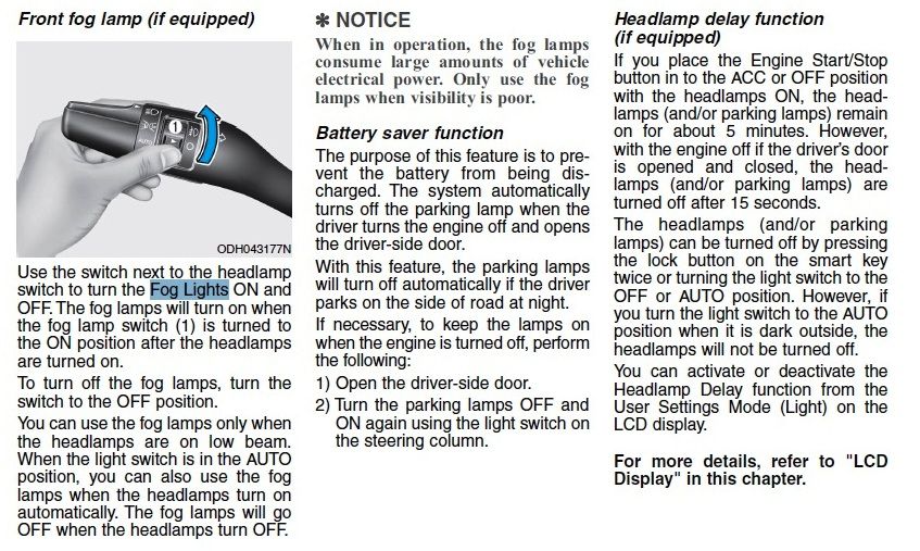

Glad I came across this forum so much info. I ordered a Black Ultimate with Ivory last week and the dealer didn't have one in stock so I had to wait for him to get it.... In the meantime looking at pics and owning a black car in the past I changed my mind. I decided on Empire State Gray with the Ivory. When I told my dealer he was annoyed but said he would try to locate one for me.... Well he said he couldn't locate one and he had the black one.... Long story short I went to the dealer and looked at the black and just couldn't do it so I asked him to locate a Parisian Gray with Ivory for me and he was able to. Thank god!!!! So I will be getting it tomorrow or Tues. I already ordered the rear wing emblem as well as the fog lights off ebay. I can't wait to have everything done. I'm going to debadge and add the rear wings, tint the windows and add the fog lamps. I'm coming from 2 back to back Mercedes E350 leases 2009 and 2012. Both of those cars had the fog lights on in the day so I want my fog lights to be on all the time on my new Genny. Can I just wire the new fogs to a spot in the fuse box that powers up when the car is turned on? Thanks in advance on any advice.

Regarding the Fog Lights. Per the manual they consume major amounts of power and clearly state to only use them when you need to see. Read below...
Yes, that is in regards to the engine being off. I will wire mine to an accessory fuse that is only powered when the vehicle is running. Just think if you added an amp to any car how much more current it would draw over any type of light.... I don't think it will be a problem while the car is running. Thanks for your input and I will keep everyone posted when I get everything done and running.

Depends on how you interpret the warning notice. The other issue I would be concerned about is if this would void and warranty.

If you are going to use additional lighting then I suggest wiring it in using a relay switch that uses low amps and power straight from battery. This would be less likely to overload a circuit.
Thanks! A relay would be used to switch them on when power is detected from another power source ie. headlights or DTRL. I am fine with them being on whenever the car is running. I will ask my mechanic what he thinks the best option is. My plan is to have them on their own circuit.
Full time connected directly to the battery via a relay so they come on with the low beams would be perfect IMHO. Only drawback is there is no way to turn them off however this is easily accomplished by installing a wireless switch which I have used on ebay which would work wonderfully. This would give you a small remote control which you can leave in the console to turn on and off the fog lights if so desired when the low beams are on. Really convenient as you do not need to run wires from the engine bay to the cabin or install any switch. There are numerous ways of doing this however my preference would be on when low beams are turned on with the option of turning them off like I described above using the remote switch. This is what I am talking about. http://www.ebay.com/sch/i.html?_odk...TR0.TRC0.H0&_nkw=12v+wireless+switch&_sacat=0
